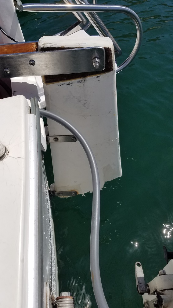

Hey Gang,
This weekend I had yet another new mishap on my boat. This time I broke my rudder while under sail. (I tried to attach a couple of pics but I keep getting the message that they are too large. Any help here?) It was perfect sailing conditions n my home lake, 10-12, a really great wind speed. We had a really strong puff, which we saw and were ready for when it arrived. I was spilling air in the main and the boat was handling all very well. Then the boat turned up hard into the wind. It was then I realized I had no control of the boat and I was without a rudder. I am so happy this happened on my home lake AND without my girlfriend on board. We were able to get the sails down and recover the broken rudder so that it doesn't ruin someone's day. I am grateful to have my outboard to get us back to the slip.

Would love to see the pictures of this... are you saying that the structure of the actual rudder failed, and not at the pins?

That is correct. Do you know how to change the picture size? Most of the time the webiste will reduce a picture to fit its requirements.

Likely water ingress through the lower bolt holes causing rot in the wood core.
I had a oem kickup rudder but it had small cracks at the edge and was delaminating.
I bought a ruddercraft kickup one and have never looked back.
Considering the age of these boats i wouldnt buy a used rudder. Likely has similar problems unless you want spend time restoring it.
@Gene Neill did have a pintle weld fail on his Ruddercraft one, but Ruddercraft told me they sell thousands of them with that gudgeon/pintle setup (likely for many other small boats in addition to the C22) without issues. Bad welds can happen and nobody is perfect. The HDPE Kickup units come with a 6 year warranty.
