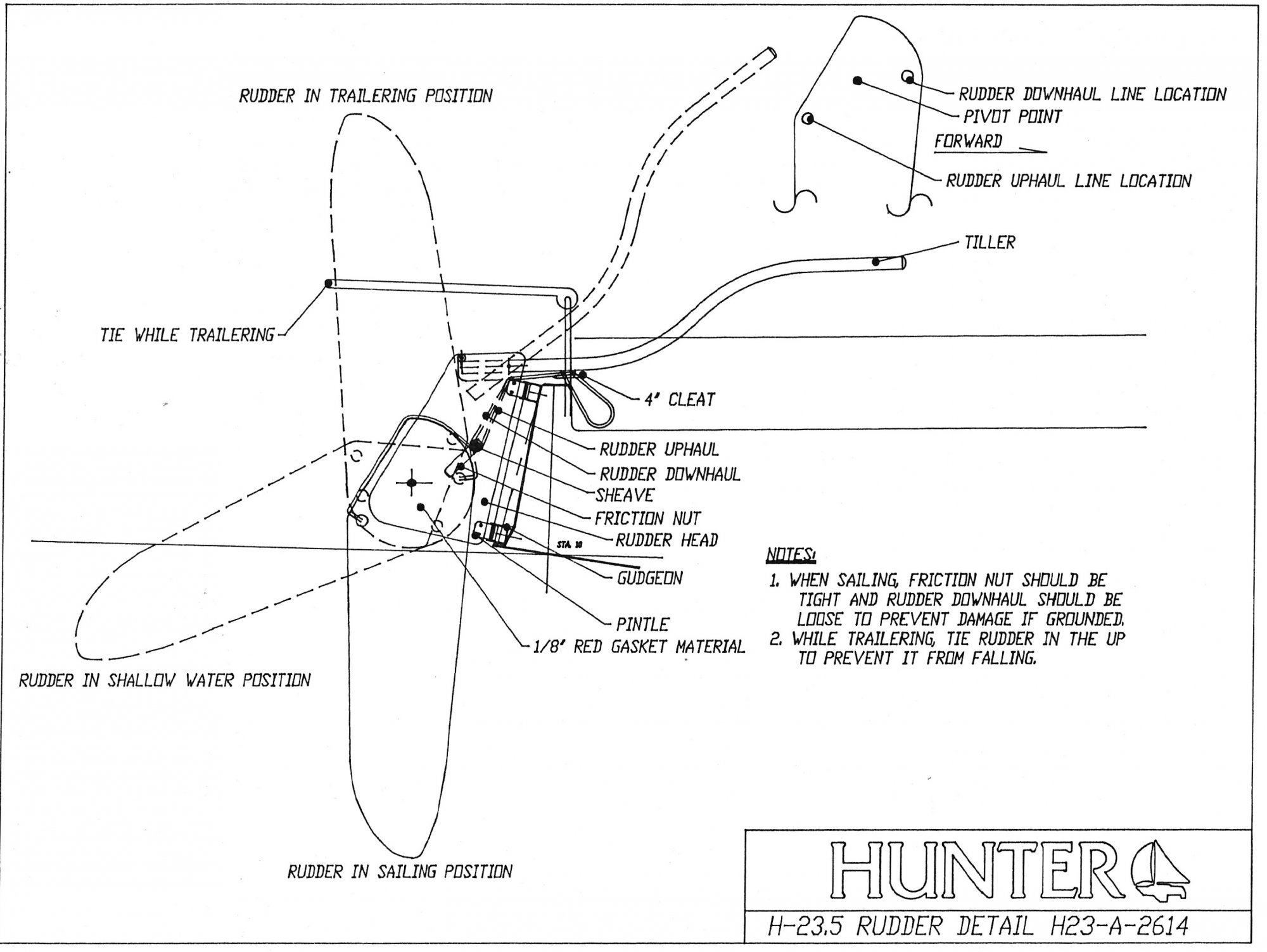

S Sailing Tiger . Nov 15, 2021 5 Hunter 23.5 Mandeville, Louisiana Apr 16, 2022 #1 I am looking for a diagram of routing for the rudder uphaul and downhaul line for my Hunter 23.5 within the rudder side brackets. Any info would be appreciated. Thanks
