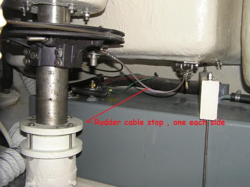

Does our C-310 have, or is it suppose to have stops on the steering system to keep the rudder from hitting the hull? I have two little paint-less dimples were the rudder travel is stopped when the rudder hits the hull.

Did you add the cable stops, or was that OEM? I know I have nothing like that below.

My rudder stops are identical to PaulJ's. My C310 is #231, 2003 model.

Hum? Mine is a 2001, and I don't remember ever seeing anything like that, and I know the rudder is hitting the hull. It will be at least 4-6 weeks before I can even get near my boat, through the snow and such. But it on the list to check out.

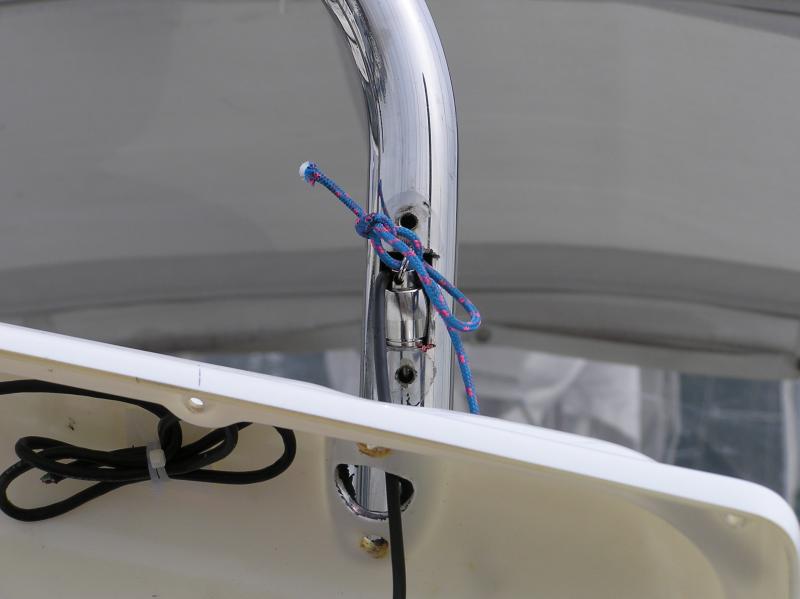

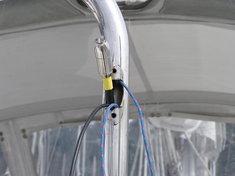

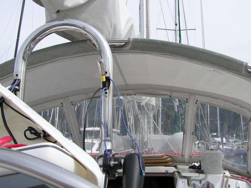

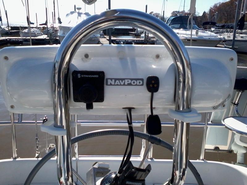

... New VHF below, with GPS / DSC and RAM MIC up topside. (still deciding best place at the wheel or on the side compartment - for ease of wire run)
Russ, I would mount the Ram MIC on the pedestal right where you are. I have mine there and would not have anything else. It can be a pain to pull "one more wire" up that crowded tube, but it will be worth it.
Sorry that all I have is a rear view, but the larger black covered connector on the left is my Ram Mike connector, and you can sort of see the bracket I made at the very bottom where I hang the mike right next to my Humminbird chart plotter. The smaller black covered fitting to the right is where my new ST50 Autopilot wired remote plugs in, :D
gpd955
Feb 22, 2006
1,164
Catalina 310 Cape May, NJ
I just pulled an 8 wire signal cable through the crowded tube and ended up using a little McLube SailKote to help it move along. Made it very simple with no residue.

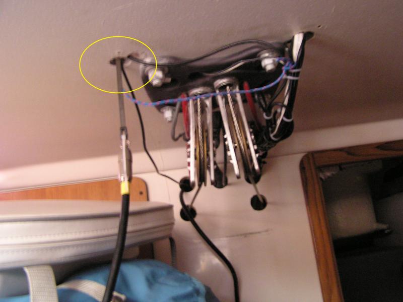

Thanks all - yes it is getting crowded in the tube, might be time to drill (grind out) another hole and come up the port tube, as all else is run the other side. I had also thought of stopping in the engine control pod, yes lower but dependent on where I hand the mic still a nice place for all. With adding the radar, I have that large cable to pull around also, but thinking of mounting the junction box below the wheel in the back cabin. (anyone have experience removing that fiberglass cover in the back that hides all the steering gear? Seems like a nice location for making all the connections between Plotter, Radar, power and VHF) Is it just screwed to the ceiling or did someone use 5200 in there?

Hi Russ, my 2001 no. 139 has the same cable stop as Paulj and is OEM. Deke
Russ
It's just screwed to the ceiling and the bulkhead, with maybe some silicone sealant around the edges. Lots of room to put in some terminal strips, etc.

Topic drift happening... but the eyelet on the yoke that the rudder limit cables are attached is known to fatigue and break off... no limit after this happens.
My cable clamps loosened up once, so no cable stop on that side. The boat was fairly new. Checked all clamps on steering, stops, etc. They were all loose.
