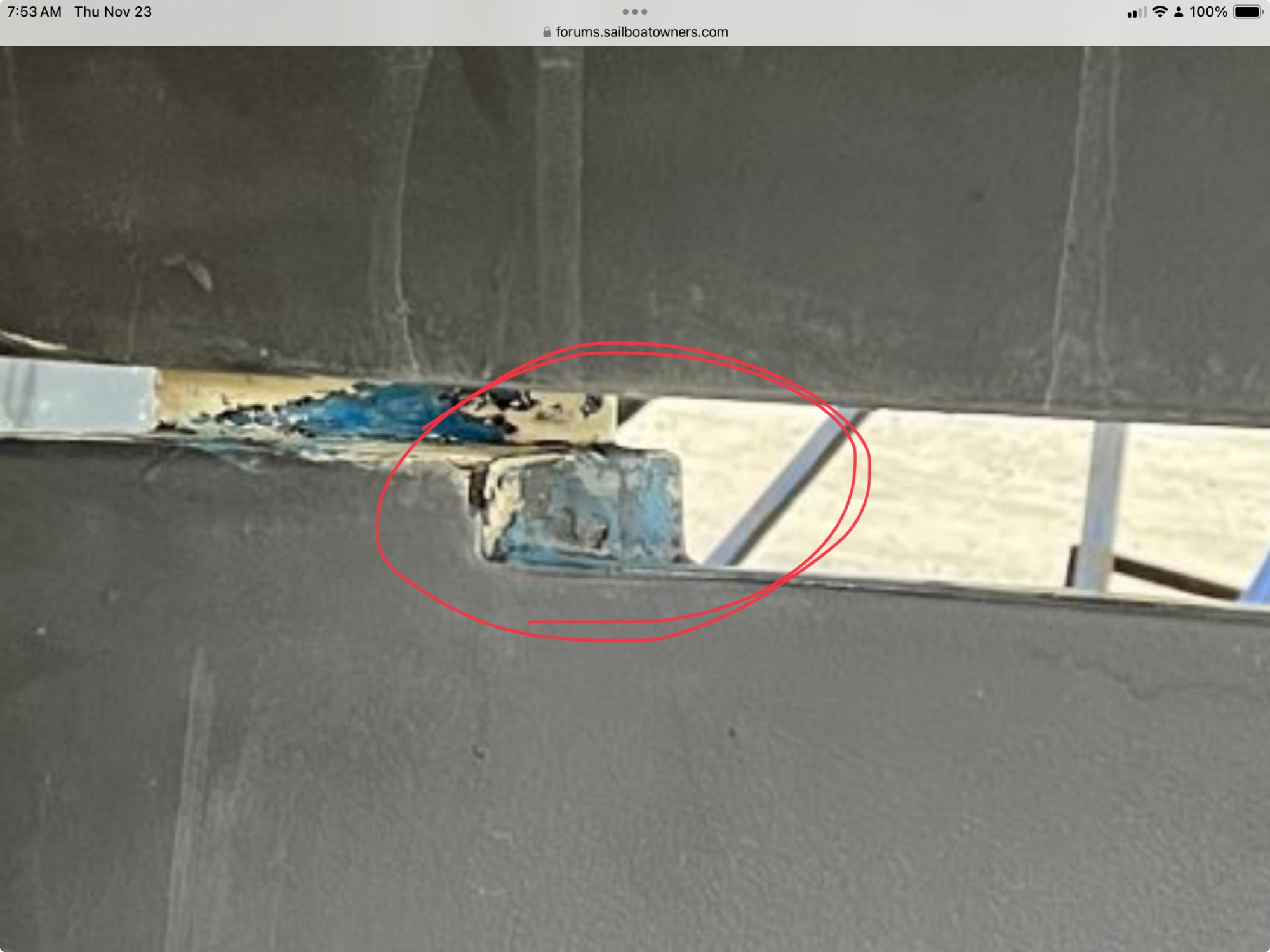

Hi survey pointed this out and wonder if anyone has had this and if any fix needed..H290
thanks
Colin
There was an approximately 1⁄2" gap between the top of the rudder blade and the bottom of the skeg. Rudder was aligned with the keel.

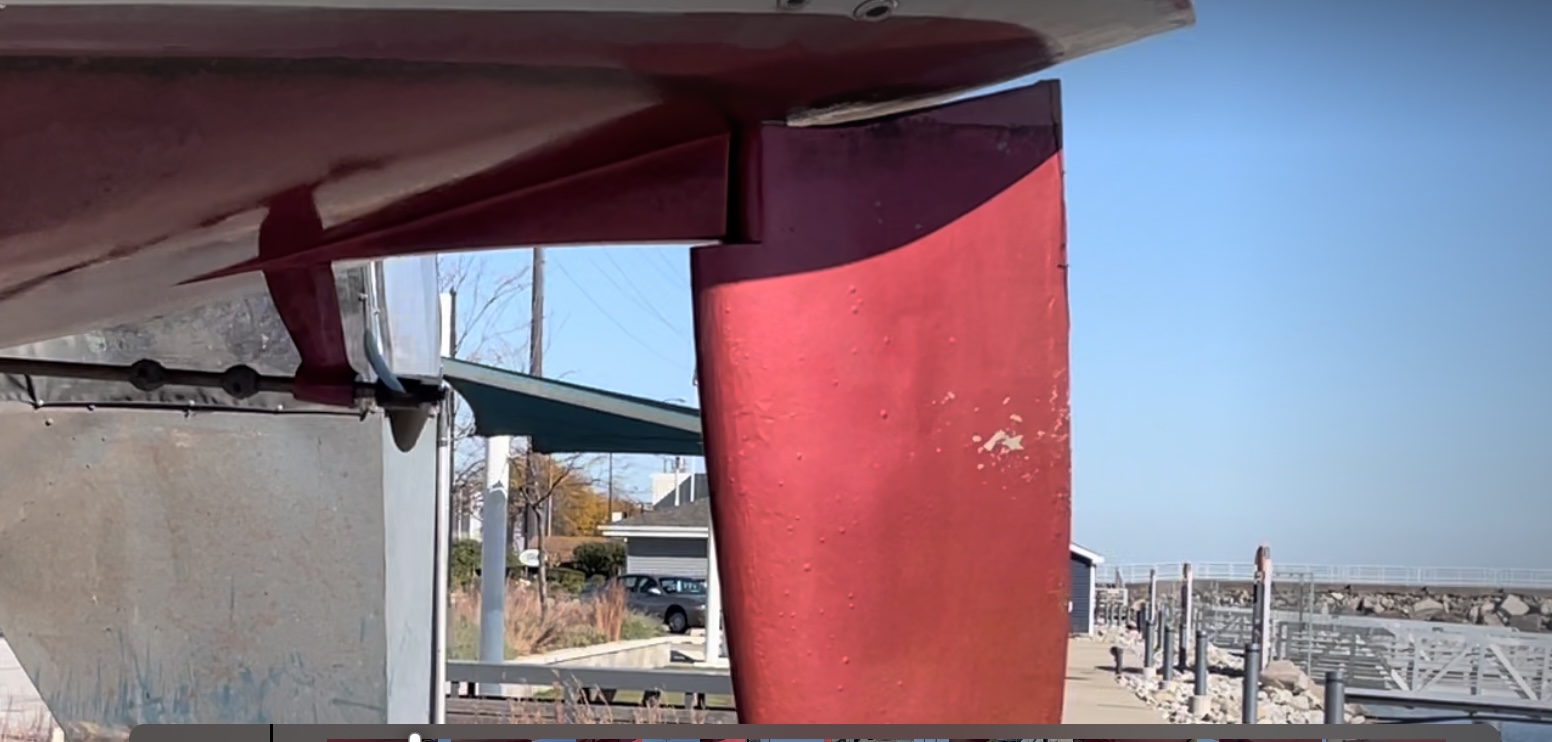

I'd ask for an explanation as I think he was referring to something else with the rudder. Below is the bottom of our '99 H-310.
Anything closer and it would risk scraping the hull.
Are you sure you have a skeg in there ? Never seen one on a Hunter.
The 306 is almost identical to the 290 and has a little demi-skeg as shown below.
There’s also just enough of a gap, maybe 1/4”, to let the winter cover tie-downs slip by. But 1/2”? I don’t think so.
Incidently, you might notice just behind the front tie-down on the skeg, there is a little defect in the fiberglass that had weakened and collapsed. This will be the second one I’ve found on the skeg in the three years I’ve owned the boat. So that’s fun.

Thanks everyone. the surveyor said it could be a bushing. On another forum there is a thread about removing the rudder and replacing the bushing. Just wonder if anyone with a 290 or 306 has had this. On the hard we can move the rudder up vertically by about 1/2 inch......
thanks again
Colin

Bad photo, but it looks like the rudder has dropped down some. What does it look like on the shaft inside?
any evidence that it has moved down?
a bearing would give you lateral movement I would think.

It just doesn’t look right to me.
I don’t understand what this area was supposed to match up with…it is almost like the rudder wasn’t made for this boat.
On my O’Day 322, the rudder matches up to the small skeg, and the parts fit together without big gaps.
Probably need to have a reputable boat yard look closely at this and offer suggestions.

looks like there is about 1/2 in of space between bottom or steering arm controll and top of rudder port. Surveyor recommended putting a spacer there. Not sure where to get one other than getting a bushing and cutting it down.. Western Lake Ontario Canada based ..
thks
Colin.
