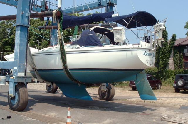

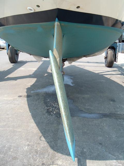

I just recently had a damaged rudder replaced on my "77 C30. In addition to removing and replacing the broken rudder (with a new one) and all that entails, they had to prep the new rudder (epoxy barrier coat). The quadrant was frozen and after many hours they gave up and had to cut the old rudder off. They also charged me ($200) to dig a hole under the boat to drop the rudder. They had the boat for 4 weeks (from haul out to launch) with new rudder. Final cost around $5,000.00. The insurance paid all except my small deductable. I have no complaints.
