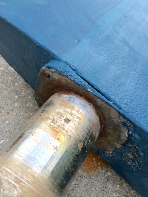

I have done this exact job on my legend 35.5. I dug plenty deep, but when I lowered the rudder, I found it needed another few inches. So I lifted it up, dug a little more, and got success. Also note that not only do you need deep, the hole has to be wide enough in one direction to allow tilting the rudder over to then get the rudder out of the hole.
these rudders are not light. You will need a block above the rudder post to lower and raise with a line. I cut a piece of threaded rod to length equal the diameter of the post, then put two nuts in the middle of that threaded rod. I tucked that down the center of the post and let each end nest into the post bolt hole. Run the nuts against the ID of the post to hold it into position. Now you have something to tie a rope to.
i spoke directly to Foss rudder owner (2nd generation). He told me that Hunter rudders had carbon steel frames inside the rudder welded to the stainless steel post. In my case the rudder was splitting along the seam and a significant amount of very rusty water was draining out. We discussed sending the rudder back to Foss and they would rebuild it, using the original rudder post. However once you consider shipping and transport preparation, it makes brand new the easy choice. Brand new will be 100% stainless steel inside. Foss will ship it to you with the rudder post extra long and NO HOLE DRILLED so you can make this exactly like the original (no two exactly alike).
i did all the work myself, which surprised Foss. Especially when I had it shipped to me instead of the boat yard. I wanted it at my place to allow me to cut the post to length and to drill the hole for the quadrant bolt. Don’t underestimate the work involved, the post is pretty stout stainless steel and you will not drill this with your typical battery drill. Cobalt drills are a must. I measured about a dozen times to make sure it was the exact place and perfectly square in both directions. I recommend drill one side side and then mount the quadrant sticking the bolt into the one hole. Then use the other side of the quadrant as a drill guide to mark the hole. Remove the quadrant to actually drill the hole so you don’t harm the quadrant hole.
