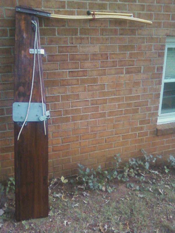

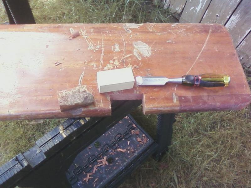

Kick up rudders are nice... but! When it is in the up position you need to steer with the outboard, otherwise you can hit your rudder blade with the prop:confused:

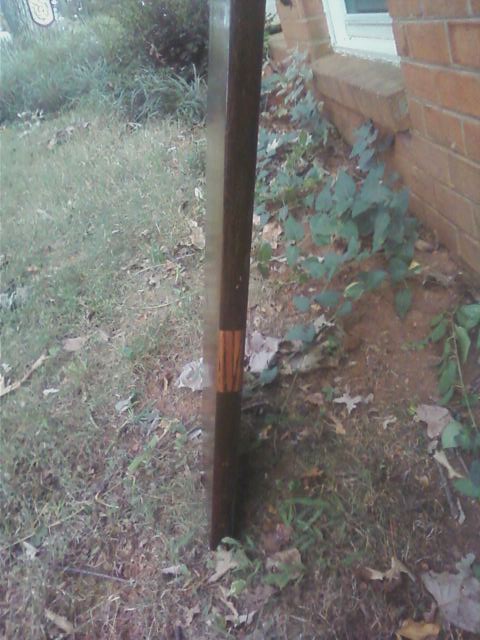

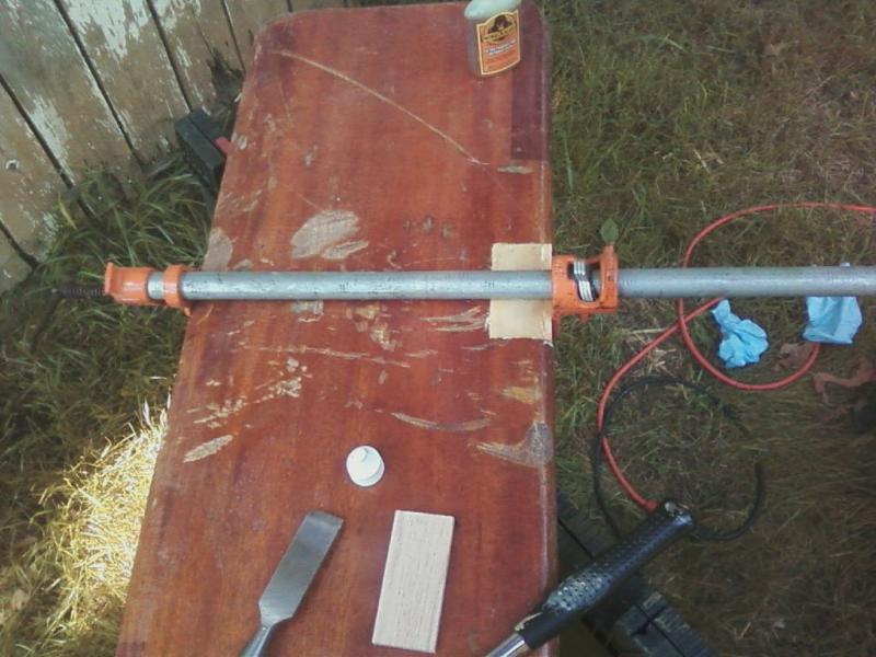

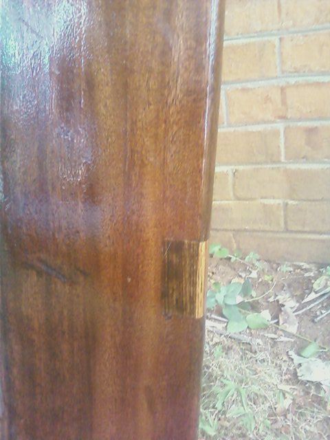

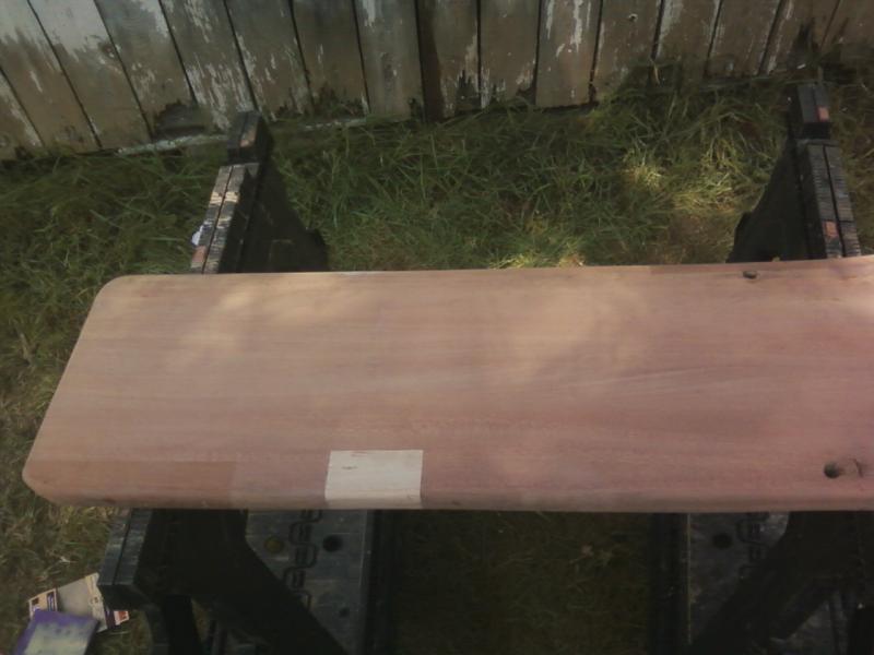

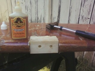

Anyway... I recently made some rudder repairs and thought I'd post the pics. in case anyone else might find it useful.
What you can't see in the photo with the pipe clamp, is that I inserted an oak slat over the screws.

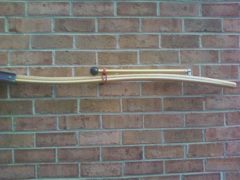

I also installed my newly made tiller. I posted the pics of its construction in an earlier post.
Fair winds and speedy repairs (to all of you caught in these storms on the East coast).

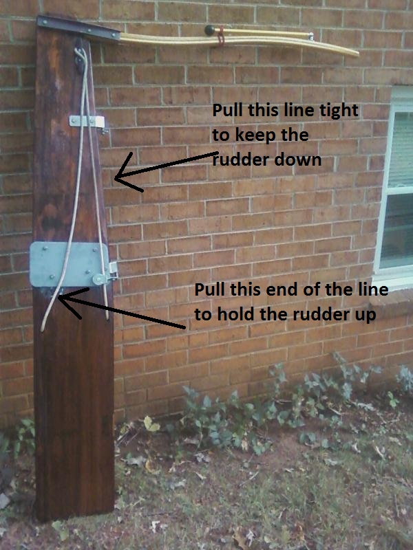

That be a fine looking rudder, rgranger. Do you, or another reader have a diagram of how the line and etc. on it are rigged? And how it operates? Mine came from the PO bolted down securely and with no instructions. After getting stuck in a low tide mud flat last week, it'd sure be handy to raise it when necessary.

Dave, the line you see in the pic below is a single line that passes through the cleat and each bitter end is tied with a simple knot on the other side of the holes you see in the rudder blade. Nothing more to it than that. You pull the forward line to hold the rudder down and then loop the slack around the cleat horn...you pull the rear line to hold the rudder up. The rudder actually floats so you only need to use the rear line to hold it up when you are at the launch ramp.
Hope this helps. If you need more pics or explanation let me know.

Thanks. Yes, it does help. Sorry to wait so long to reply; I couldn't find the original post.
