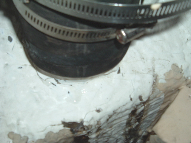

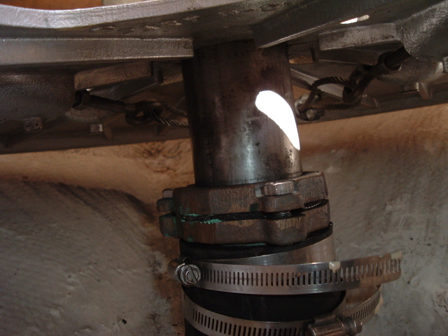

So how much of the shaft is still in the boat? I guess you are talking about the rudder tube(see picture). I guess I didn't know that was brass. Cannot imagine why the shaft would hang up there unless there is a bend in the post. But that would be unusual at the top.

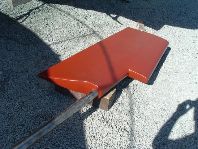

They lifted my boat with the travel lift and the rudder fell out. I did not touch the stuffing box. Why not, as next step, disconnect the stuffing box from the bottom and see if it will come off over the top? And why cut off the bottom? The rudder is built with a frame and you would be removing part of it. I think the end of the shaft and the attached plate are at least 12" from the bottom.

my packing valve looks alittle different than yours, I also had the angle Iron across the transom, removed that to get to everything... the rudder on the boat is shot, shaft way bent, skin cracked and broken in places, so its not salvageable. new one on order and will be here this week.

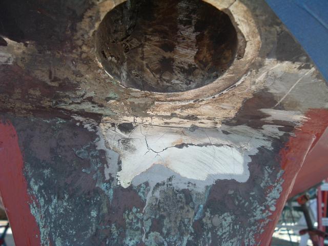

My pictures, both inside and outside, were taken when I was noticing the spider cracks. I assume those are from a grounding. Maybe the one that bent my rudder stock. They have been covered with epoxy and cloth.
