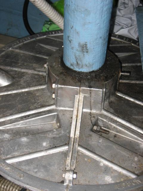

I was on the boat today trying to remove the rudder. I was able to remove or loosen all the bolts except for one - the through bolt that hold the rudder up. I was easily able to remove the nut, but the bolt does not want to budge.
I tried to take the strain off the bolt by looping a line under the rudder and pulling the rudder up. No difference. I sprayed liquid wrench all around, tapped with a hammer, etc. no difference. I'm afraid that if I REALLY try to turn the bolt it will snap. I wonder if the bolt is corroded in the rudder tube?
My next plan is to add some heat to the quadrant and bolt with a propane torch.
For those of you who removed that bolt, how hard was it?
Thanks,
Barry

Barry, We had the same problem. it's a stainless bolt. If I remember right, should the bolt break the quadrant will still come apart because it just passes through the rudder post. We used a long 1/2" drive "breaker bar" instead of the usual 3/8" socket set. Surprisingly it did not break!

Same setup as mine too. The bolt visible in your photo with the double nut is the tensioner for the steering cable. There are two of those, one on each side of the rudder post. I only needed to release tension on one side. With that loose, you then need to undo all of the other nuts /bolts that you see in the photo along with the corresponding nut/bolts that are unseen in the photo. This will allow the quadrant to break free from the rudder post. Keep the main pin in place (the one seen in the photo going through the quadrant and the post). At this point, make sure you have a sling under the rudder to keep it from dropping out until you're ready. Once you pull the pin, you can lower it to the ground. So to summarize, you pretty much need to undo everything on the quadrant except one side of the cable tensioner.

I had to remove all the bolts and then use a series of wedges to split the quadrant and remove the two halves separately. The long through bolt was quite frozen in the quadrant.
I tried heat, liquid wrench, patience, hammers, large ratchets, nothing worked on the through bolt. By hammering wedges between the halves I was able to get the back half off. Then I was able to drive the bolt through the rudder post and I removed the other half of the quadrant.
The rudder is free to drop down. I dug a 3' deep hole to drop the rudder down into, but there is a large (2" diameter) root about 6" from the bottom that I could not chop with my shovel. So tomorrow I will fix the root with my new sawzall.
When I got the quadrant home I set about getting the through bolt out. I tried turning it - the head stripped. I tried a large hammer - the bolt bent. I tried more heat and liquid wrench - nothing. Then I tried hammering again. The bolt moved about 1/4" but then stopped. And by now the bolt was so bent that it was never going to fit through the hole. So I got out the heavy artillery - my big grinder. I ground the head off the bolt and then used a large punch and hammer to drive the bolt out of the quadrant. Success at last.
