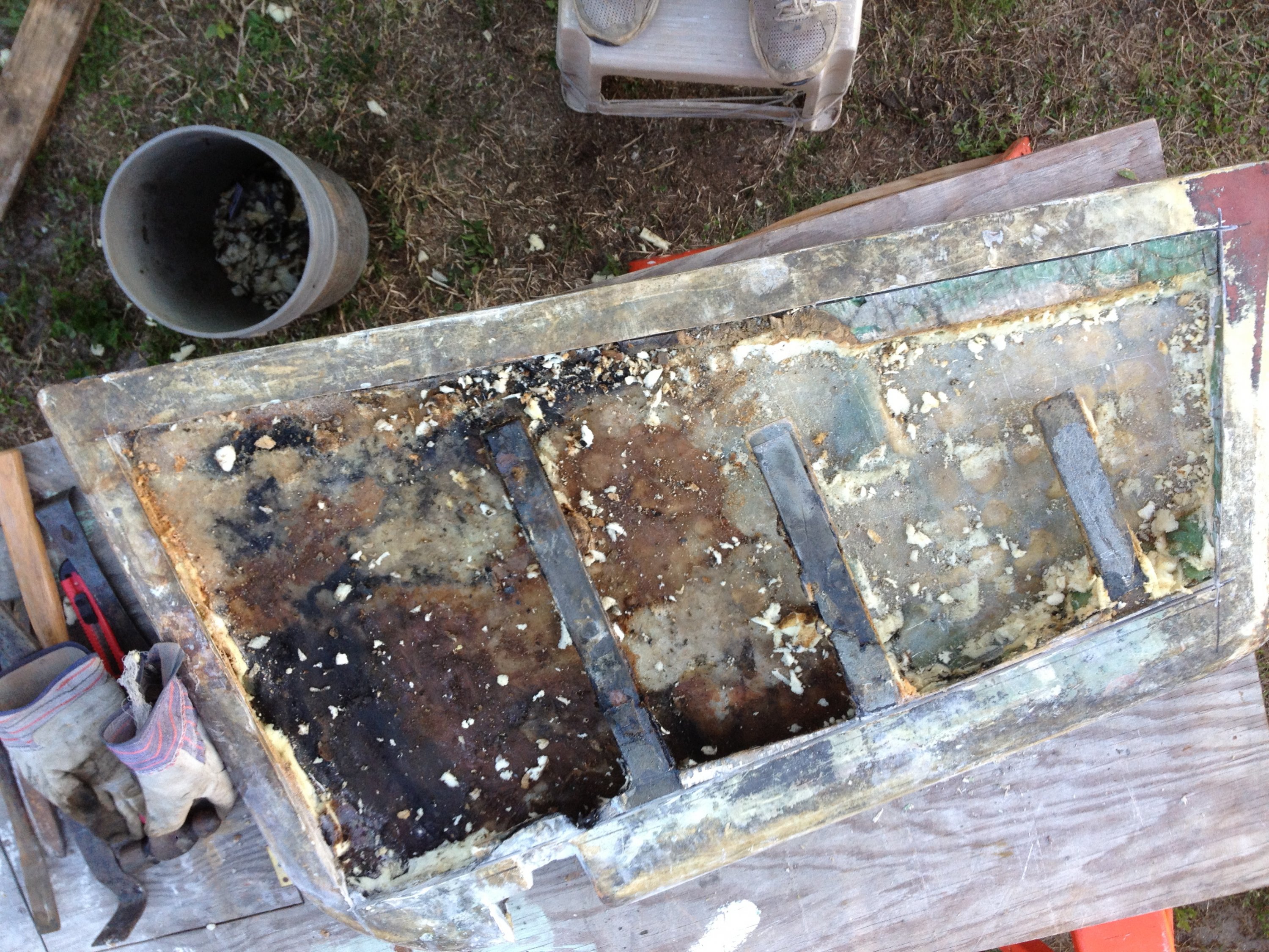

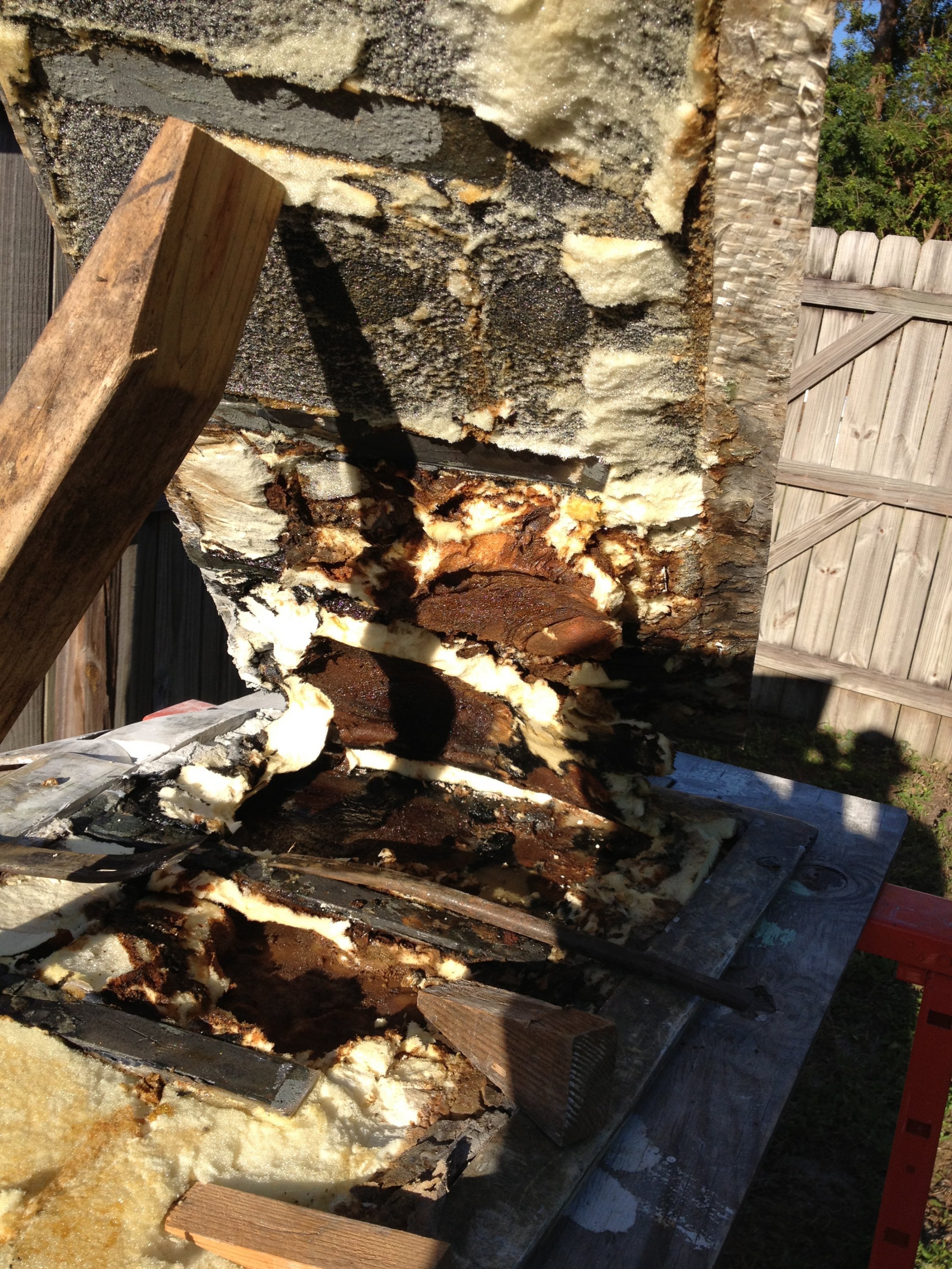

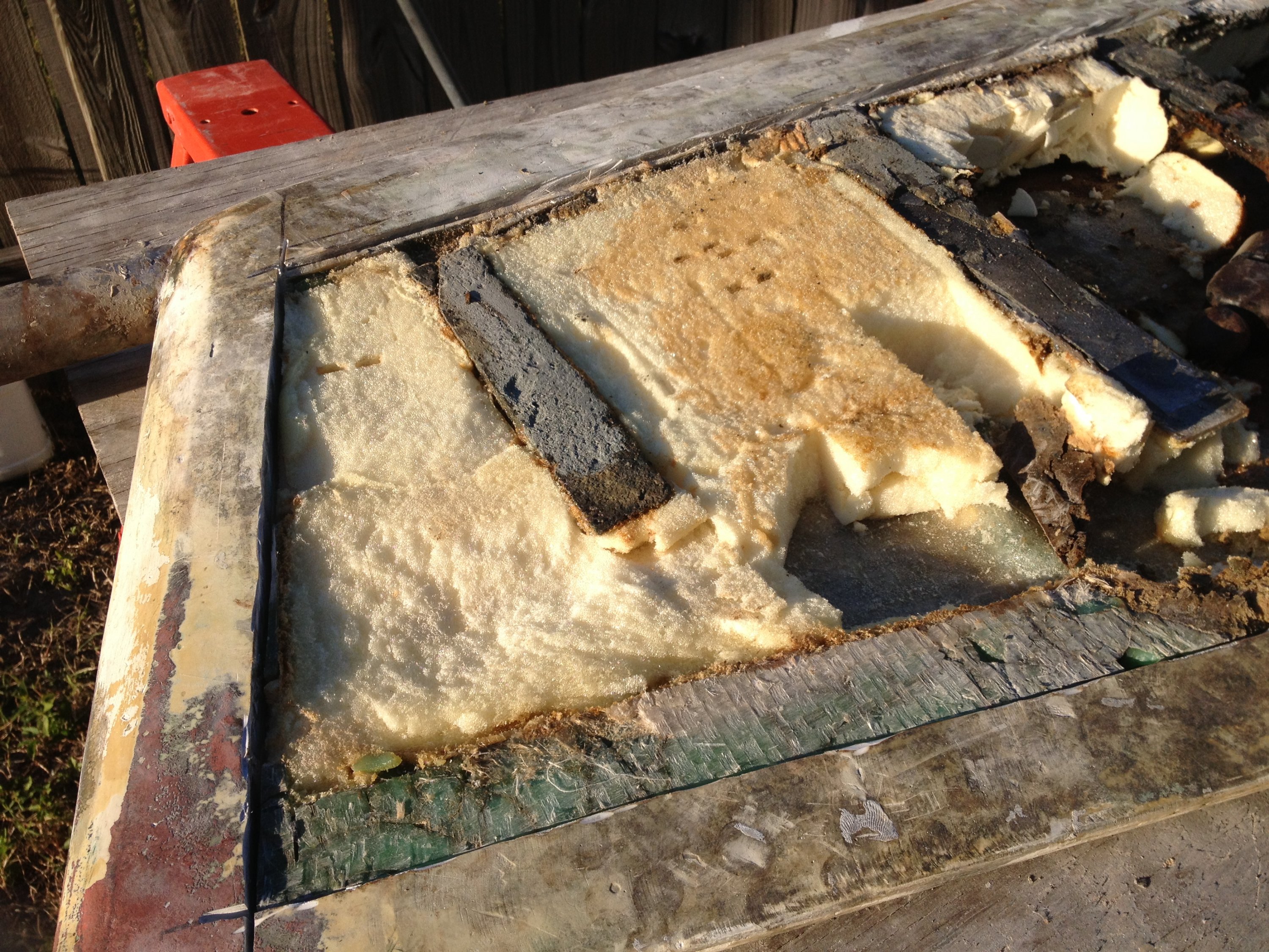

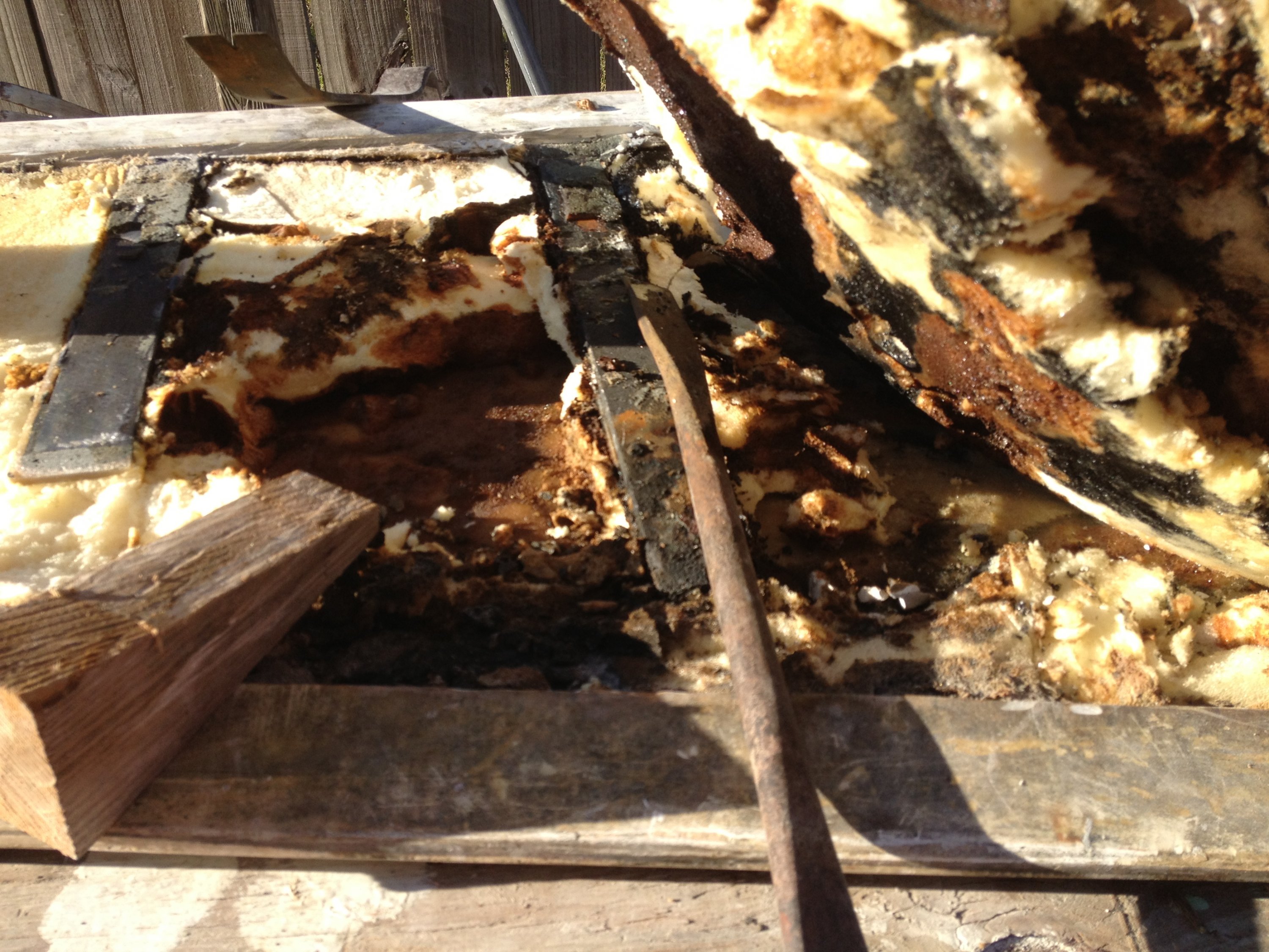

I have my rudder of and am about to open it up for a rebuild job.
The standard procedure is to use expanding 16 pound foam as a rudder fill. At least that is what I have found in my research.
Anyone have any advice for a different material that would not absorb water and not be too heavy?
thanks!!
PaulK

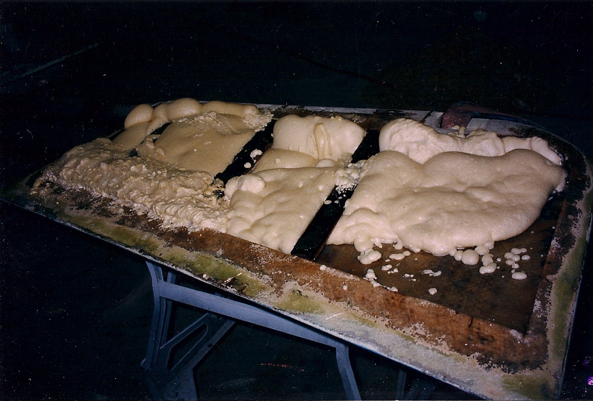

Looks like the method you suggest- using expanding foam- doesn't work very well. The photo shows all sorts of space that the foam didn't expand into. Water gets in and... there you go. Though it would be more work, getting non-hydroscopic foam boards and shaping them to fit in the space might work better.

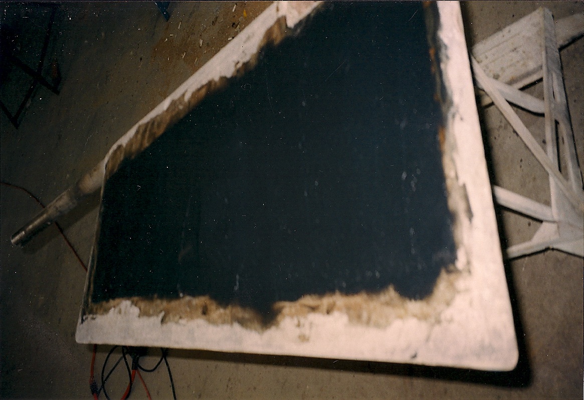

Paul, that picture was when it was under repair. More foam was added and the holes filled. I have only 2 pictures. Will post the other one here.
The black was vinylester fairing compound. The rudder was then reglassed over with a vinylester layup.
