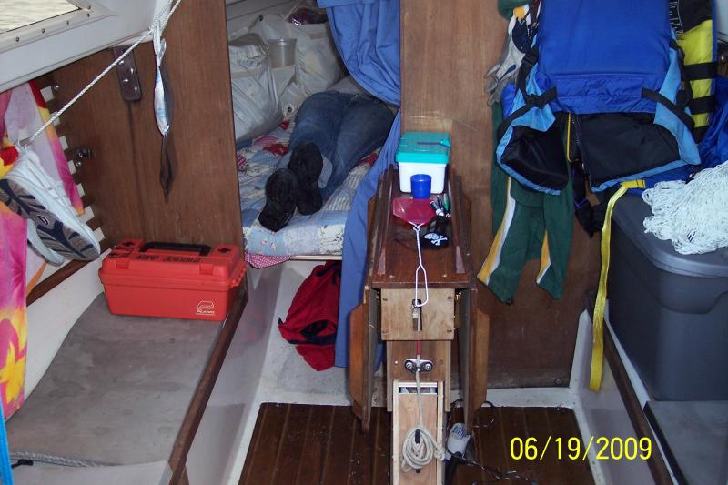

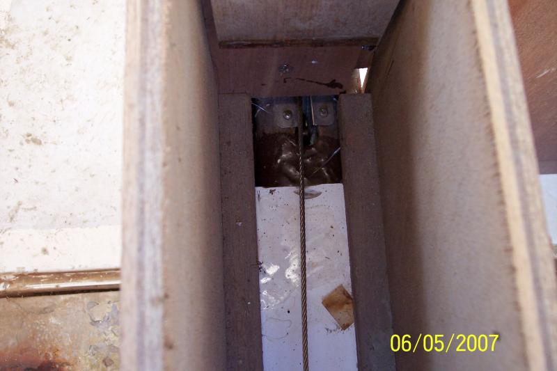

Greg,
My mistake, I misread your entry. Are you talking about the rudder ONLY in this thread, or both the rudder AND the swing keel ??

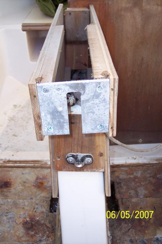

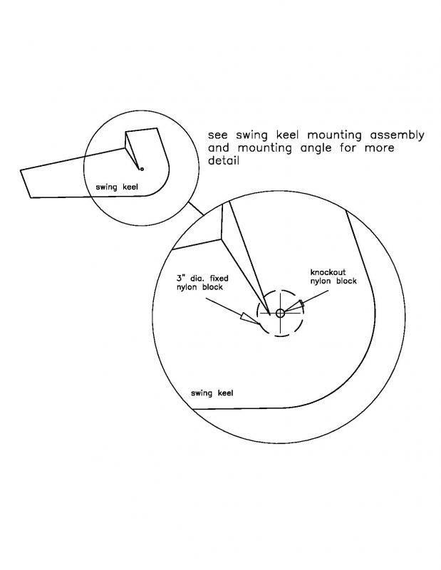

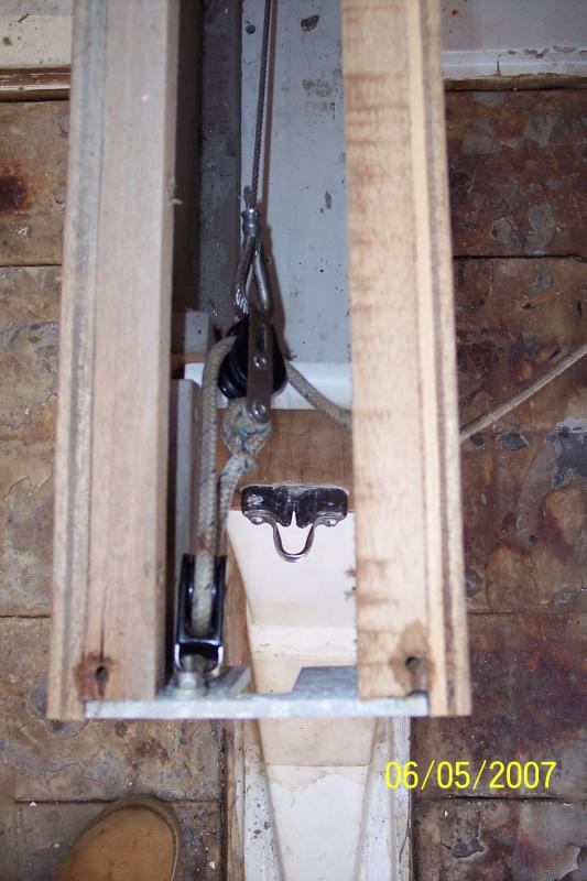

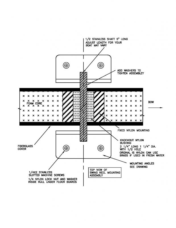

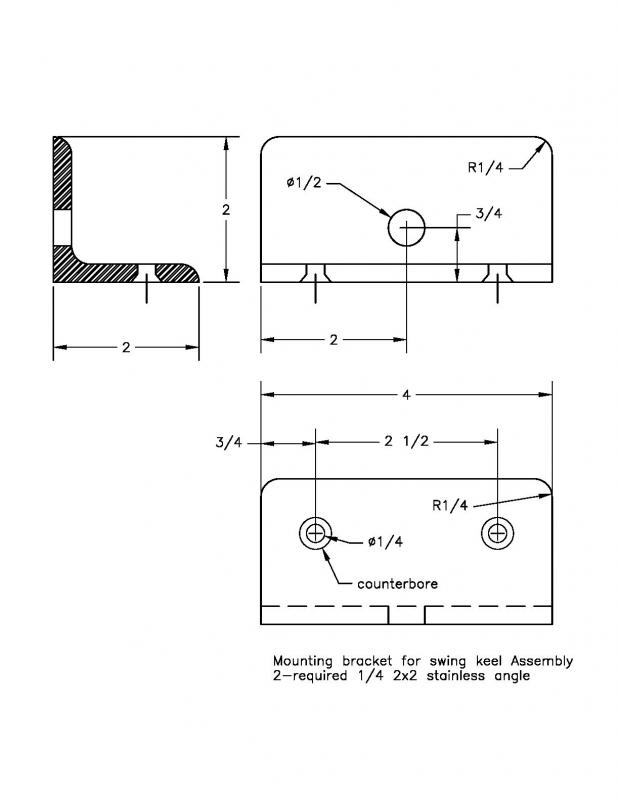

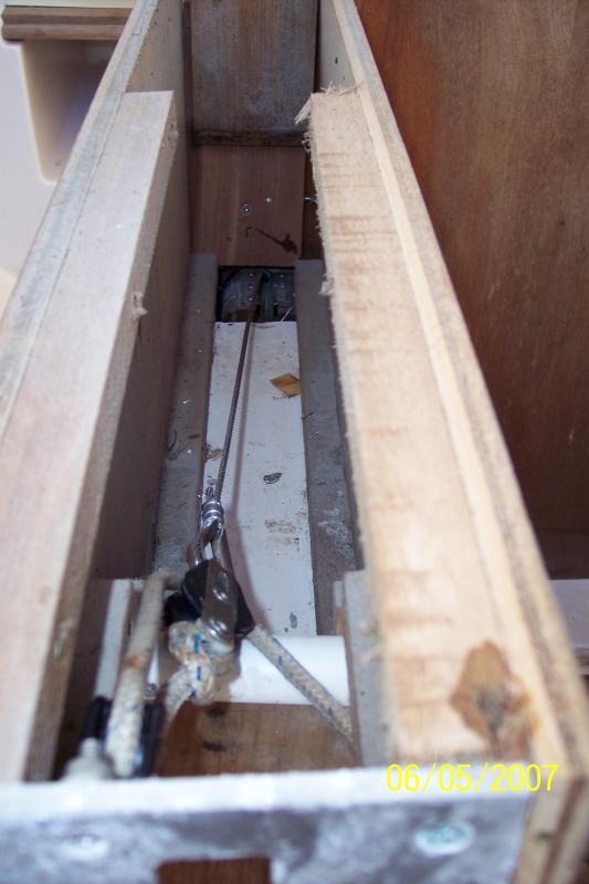

Anyways...here are pix of my 1981 Hunter's swing KEEL trunk along with some diagrams. Hope this helps you in your KEEL endeavor.
My RUDDER is made by Ida Sailor (not original), and I like it TREMENDOUSLY !
Anywho, both the keel and rudder discussions are in the common thread mentioned above.

Thanks for your replies. Thanks also for pics. Actually, I'm rigging up both keel and rudder. On the keel, I hope to come up with a way to fasten the line that holds it in the down position so it will release itself if I run aground, so I don't bust off the keel.
I'm hoping to come up with a lever-action device that will put enough drag on the line to keep the keel down while underway, but will also allow the line to slip out under a greater load. Charlotte Harbor has numerous shallows, and I hope to go in close by swinging up.
