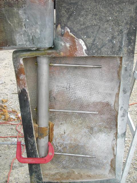

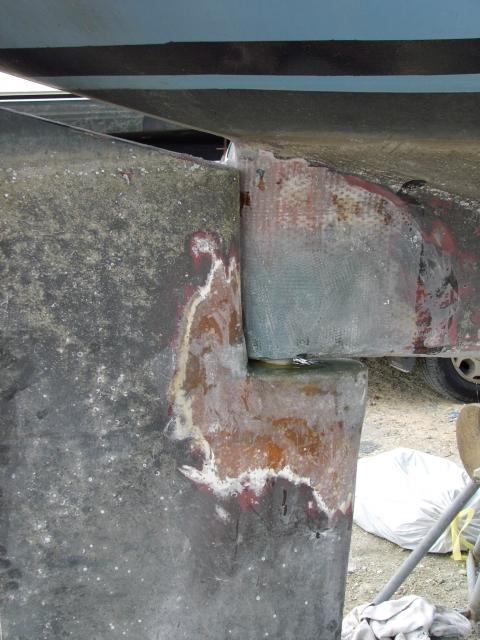

Finally making some visible headway. What a project. Who ever designs boats has to be a sadist or worse. The rudder on mine is held up by a bolt/bushing arrangement under the floor. But it is in basically a box, with only an inch of clearance above it, and under a 4" hole. The bolt is over 4". There is absolutely no way to get it in there. I thought about using two short bolts, from inside the tube, which would be possible, but the emergency rudder uses the long bolt, and would not work without it. After a lot of head scratching and thinking, I finally found a solution. I cut a 1" hole in the back of the box, which allowed me to get the bolt half way in, and with a pair of needle nose, the rest of the way. Voiola. As you can see in the pics, I have a little finish sanding and feathering to do, and add a little clearance between the front side of the rudder and the hull. But progress is progress. Hopefully tomorrow I can get that done and start glassing things back together.

I still can't believe those cheesy little tubes are the only thing that provide any lateral strength in your rudder. Of course it survived this long with that design and to be honest I think you would have been worse off if your rudder had been more firmly fixed in some fashion. You easily might have lost it entirely.

Core
Have ordered some 8# urethane foam for the core. Hopefully a couple more days and that puppy willl be done.
