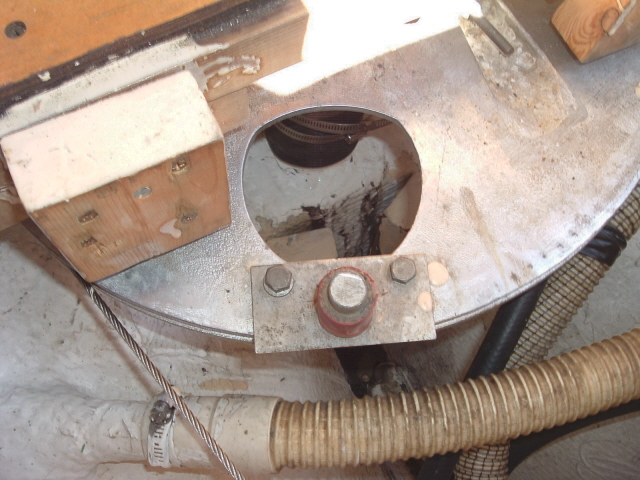

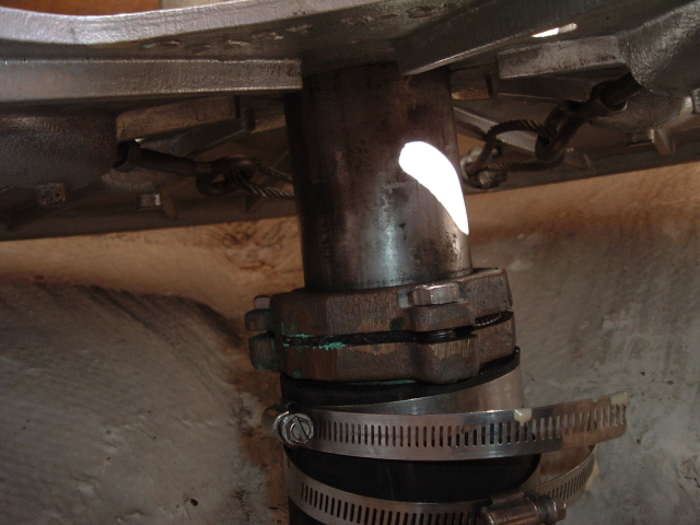

First there is the removal of the steering radial wheel. Loosen and remove the steering cables first. Then the bolts that clamp the two halves together(pictured). Finally a bolt through the middle of the rudder stock.
Now all that is holding the rudder in is that collar on top of the plastic bearing. With something to provide lift under the rudder(I used a scissors jack) remove that collar. The rudder is ready to slide out.

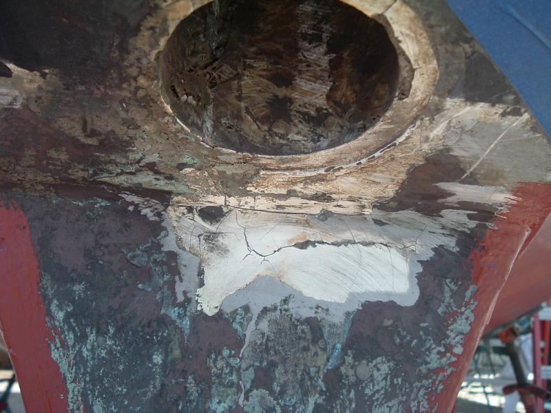

There are two sources of leaks back there. Obviously the stuffing box. But if the boat has been grounded you might have some cracks. I discovered those when I had the rudder out for a rebuild(bent rudder stock). First picture is stuffing box, second is of the cracks.

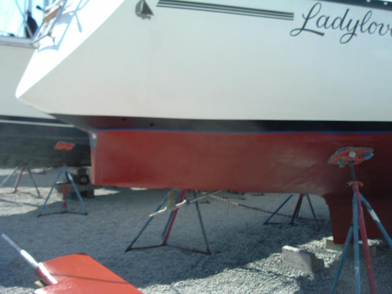

Now Ed, if you had the deeper draft model, your rudder would have been fine. A little lead grinding and filler is way easier than dropping a rudder and then glassing in such a confined area.

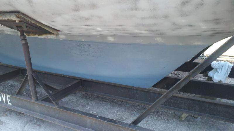

Not sure I agree Bill. I have done both and that keel is no fun. You can't take it home or work on it standing up. Just finished fairing and barrier-coating it this summer.
