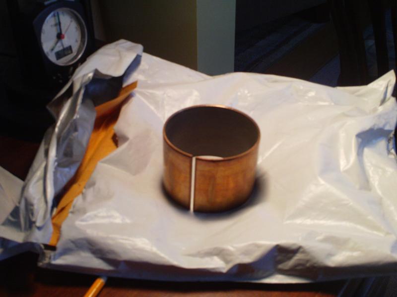

Is this the "Fendue Ring" that Beneteau sells for about 430 $ through their Syselios parts ordering system ?
I'm about to order one for my First 405, and was shocked when I noticed how expensive it is !
mibene
Nov 19, 2011
6
Beneteau 285 First Thames river
Yes those are pictures of the Fendue Ring, for a 285 first.I did buy it
thru Beneteau for under $100. It took a week for the order to come in
and was well worth it for me. If you have any questions on the
installation, let me know.
