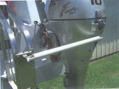

Pretty slick, Bing
I spent about $75 for my tiller link but I guess you spent, what, $5.00? Looks to be every bit as good, too.Any steering link is better than nothing, and Arlyn's mod is OK if you want to remove it while sailing to avoid a constant bias.Since I can't get the outboard back down easily on an H240, I just leave it down (no racing for me).It's good to always track the outboard to the tiller in an H240 or H260 because the rudder uphaul line can (and did to me) foul the prop in a backing manuever where the outboard's tiller is to starboard, or if you center the outboard and try to steer with the rudder.
