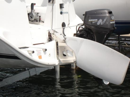

I modified the rudder mechanism for one of our area owners of a New Hunter 25. Hunter had the right idea, but it needed a little tweaking. In the up position, it would not clear the water when on a lift and on the trailer, it was dangerously low for driving through a dip in a road. The pulley system was also an unnecessary nuisance that was eliminated.<img src = "">

Hi Jeff, I have a Hunter 25 which I just bought used. My steering rod attaches from the outboard to the side of the rudder post. Needless to say, it doesn't work and the boat steers terribly. I saw your motor hookup, which attaches forward of the rudder post. This is what I need. Can you tell me where you got it or the make of the steering rod system? Thanks, Barry

Barry, I used a piece of 1 1/2" aluminum angle to extend the hole 8" in front of the rudder pivot point, which was the same as the motor. For the connecting rod, I used 3/8" aluminum shaft and bent the ends at 90 degrees with a 1/8" hole in each end for a retaining clip. If you get it within 1/4" or so, you can fine tune the alignment by moving the motor to the right or left a bit. On the rudder end, use a quick release clip tied to a string, so it isn't coupled when you raise the engine. This minimizes steering drag when you are sailing. If you have problems with the rod not staying where you want it when sailing, you can attach a piece of bungee cord to hold it where you want it.

Thanks Jeff. Did someone fabricate the bracket for you? If so, I would be willing to pay for the bracket. I don't have the means to make it. Otherwise, would you have a drawing or a few more pictures so that I can see how the bracket attaches to the rudder post? Thanks, Barry
