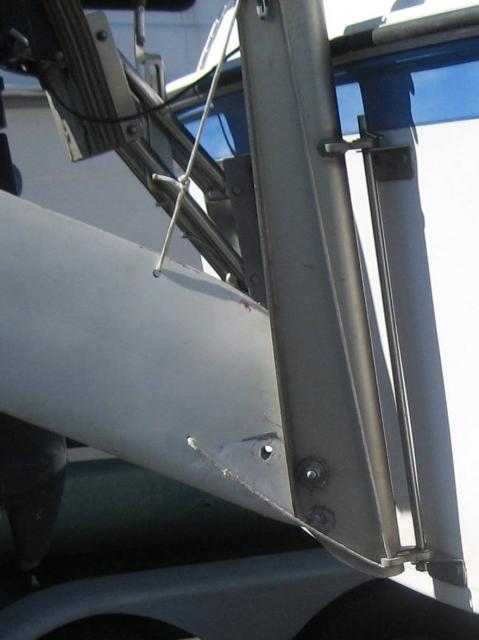

Have you see duckworks.....
http://purplesagetradingpost.com/sumner/macgregor/rigging-1.html
It has worked great for us. I mounted it on the other cleat that was there, but it isn't needed and and I'll probably take it off.
It works great, easy to put the rudder up or down and it only releases when it should.
I'm not sure how the lines are setup on an M, but if you could use one of these I'd try it,

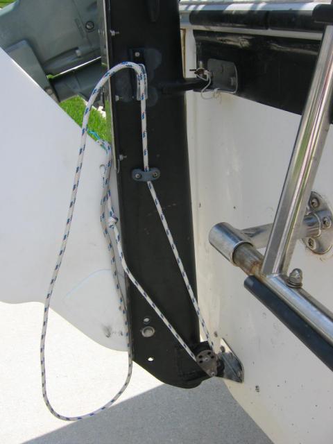

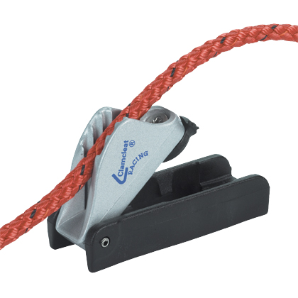

I used a cl257 automatic rudder cam cleat and mounted it on the rudder channel near the top. The cleat doesn't show in the picture. I have since added a small block to the bottom. Some people use a cheek block below.
The system really works. I ran into some kelp a couple of weeks ago and the cam popped.
Before this I used to used plastic bolts found in the plumbing department in most hardware stores (used to hold toilet seats in place). I got tired of bending over the transom and losing sunglasses.

I also use the CL257 and wouldn't have it any other way. Holds when it is supposed to and releases when contact is made.

I have the auto release cleat too.
I have also used grey plastic toilet supply lines, cut to shape, and added a ring to pull them out. fairly ridgid but hollow.
I have yet to have the auto release cleat pop.

Justin, there aren't turns as one would think, but rather an angle of around 90 degrees with a plus at one end and a minus at the other as I recall. I have mine set at the middle and it's never released unexpectedly. It's good to pop them out and in a once in a while to make sure they aren't stuck (Cheney may not be as hard on them as the Gulf, though).

There is a eliptical disk that adjust the release tension. I set mine to max and it popped just fine.
