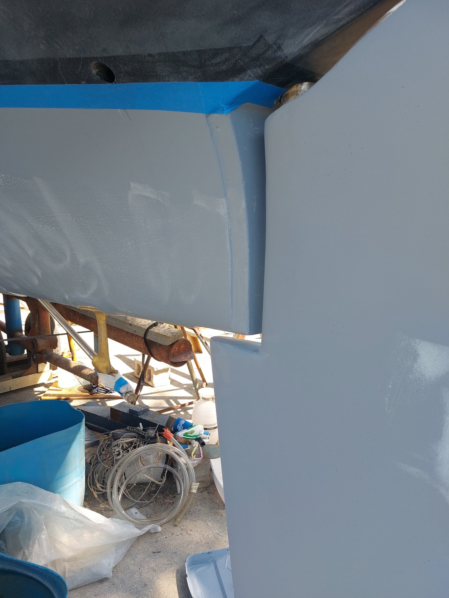

There were broken remnants of rudder flaps when we hauled out that we threw away. Since then I have filled the holes and i am reconsidering if I want to try to fabricate flaps or just leave the holes filled and not mess with it.
I have read about cavitation and I tried to find a thread here talking about it with no luck.
Am I fine to leave them off?
Thanks!

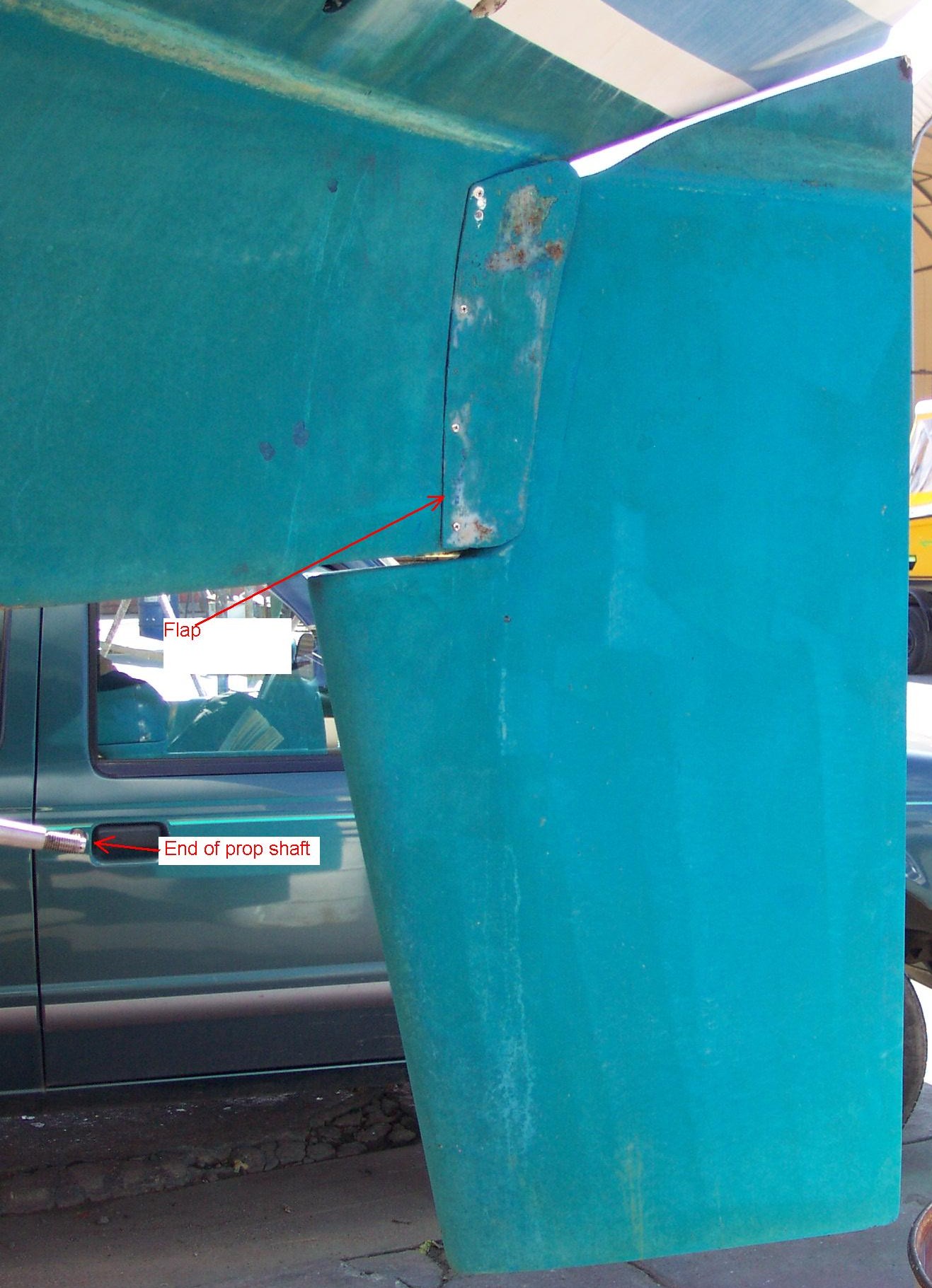

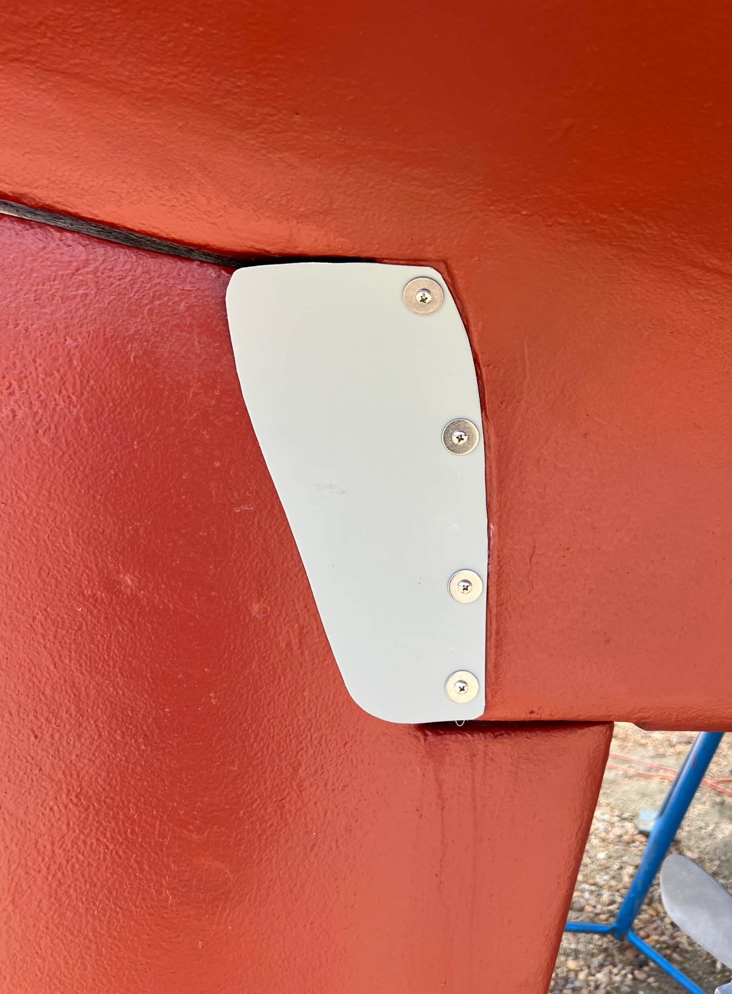

The sky will not fall if you don't replace the flaps, but if you want to preserve the original design this is what they look like. I still have them.
1,078
On my old H37C, the glass was thick where the flaps attached - at least 1/2". I redid the screw holes, using a 10-24 bottoming tap and just used short SS machine screws (with a dab of silicone as 'Loctite') to hold the flaps on. I never had any issues and never worried about leaks because the holes didn't penetrate through the glass. I suspect the flaps are worthwhile, otherwise John Cherubini wouldn't have specified them in the design. It would have cost Hunter some money to incorporate the recess for the flaps in the molds and to make and install the flaps, so they must have thought it worthwhile too

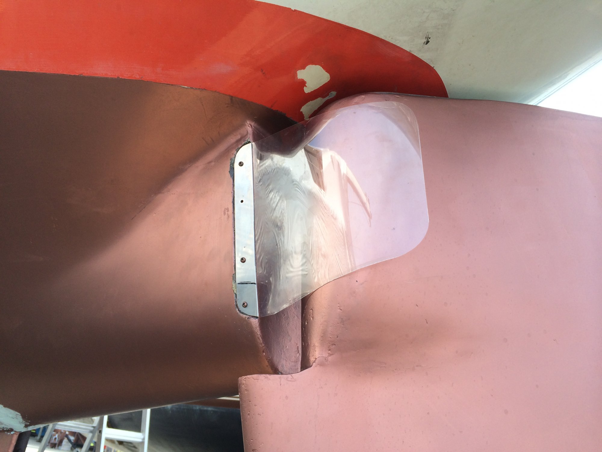

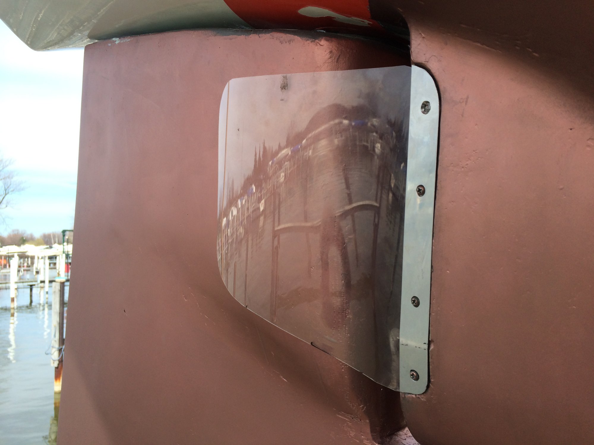

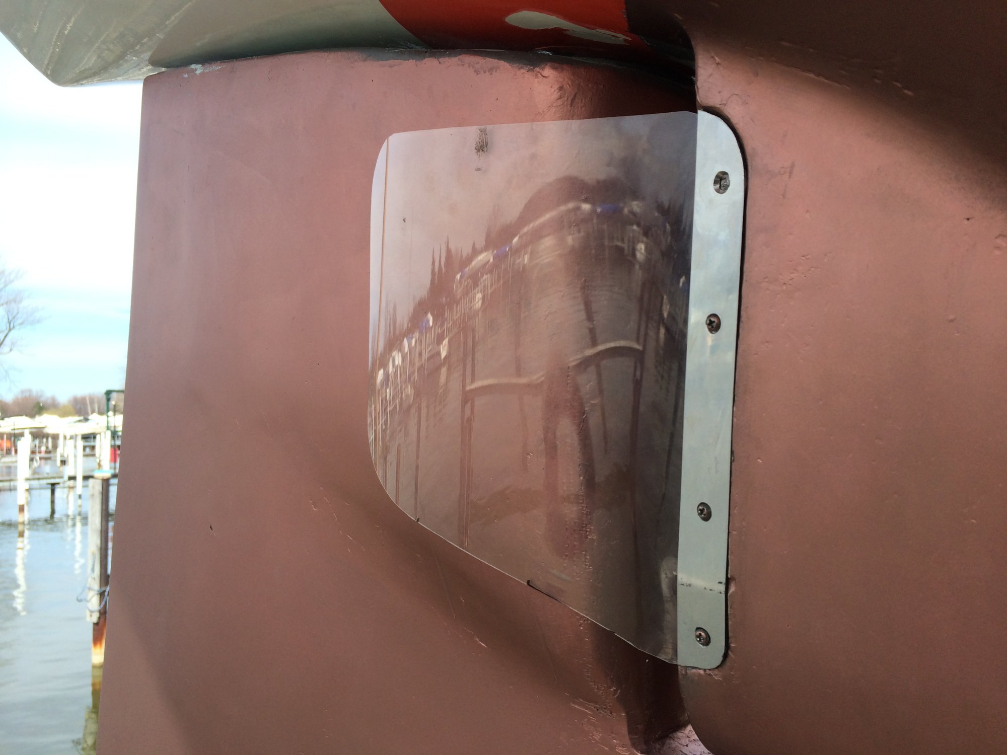

Different boat, but same application.
On a Chaser 33, I used 0.010" mylar sheet, with a 1" wide stainless strip at the fasteners. Worked great, was thin, and the water kept it tight against the rudder, even when turning.
Would get 2-3years on a set, but after that, the yard would hit them hard with the power-washer and 1 would eventually crack.
I made them longer than the rubber version probably would have been, but I felt this allowed the water flow to hold them on a more fair-shape.
YMMV
first pic, rudder straight
Second pic, rudder turned full-stop

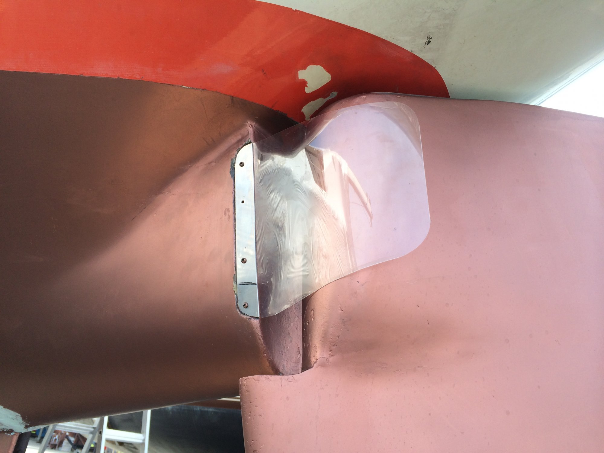

YMMV
I realize this a hi-jack - but is that a copper coat bottom paint job? If so - you happy with it so far?
May 9, 2020
161
Hunter Legend 37 Harrison Twp, MI
VC17 for fresh water... not for saltwater or brackish... but yes, on the Great Lakes, it works well... but our boats only swim 1/2 the year!
