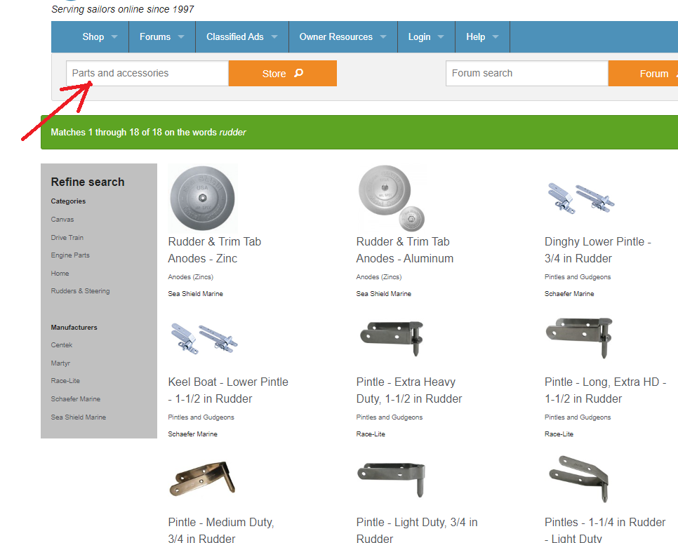

The H22 has a transom hung rudder. You need guntel and pintle
You can get them right here at the SBO store
Go here and type in "Rudder" and you will get this landing page full of choices
