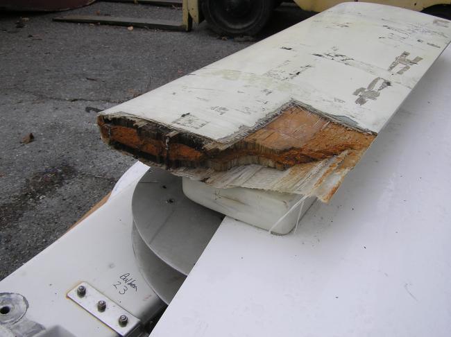

I was looking at a pile of broken rudders in the back lot of IdaSailor and I thought they might make an interesting discussion... The first picture is of a broken J boat rudder: gelcoat, fiberglas, wood and foam core. I include it to show how even well built rudders can be broken. This is a stout rudder!
