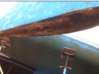

Upon hauling out my H336, I noticed the rear of the rudder has a slight crack about 2 feet down from the top. Fast forward a week and a slight water drip is coming from the crack. With cold weather coming, I am concerned of water remaining inside, freezing and causing further damage. Any idea on how to drain any remaining water out?... Drill weep hole at bottom?..... How would I repair the crack once I have drained fully?

Not a good situation. I'd drill a few exploratory holes and see if you can get the water to drain out. A shop vac might help you get some water out. Try to tape plastic on the top of the rudder so no new water gets in , but it can still drain at the bottom, and leave the bottom open over the winter. Repairs can be easily made in the spring with thickened epoxy or marine tex.
depending on the rudder material and age of the boat, the water can rot the metal rudder post to rudder material interface if left untreated. You ever dropped the rudder on your boat? Degree of difficulty depends on the steering gear, how your boat is stored, ( a dirt yard lets you dig a hole to drop it if necessary) and how sure you want to be, but taking it inside for the winter will guarantee it won't freeze or crack. Good luck.

Drilled 2 weep holes and was surprised how much water drained.....was glad to see that it was clear water so perhaps I caught early. covered crack with plastic....Thanks for the advice all.
