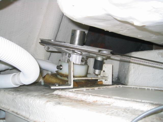

Went to the boat this weekend and discovered too much wobble.
I read warrens info, and a great instructions on twentyeightfive but were can I find the bearings or specs for the to have them made

The 28.5 has two doughnut like nylon like bearings; the upper one is thru bolted to the rudder stock under the quadrant and under that, the lower one is fastened to a plywood 'shelf' at the upper end of the rudder tube with at least three bolts. Mine were 1/4" and generally worked themselves loose or widened the holes in the plywood. At the point where the rudder stock enters the hull, there may be a minor 'bearing' element where the rudder tube joins the hull. You can tighten up the system first by taking the quadrant and nylon bearings off and getting down to the plywood. Reinforce it with multiple coats of fiberglass cloth saturated in West System epoxy;. then drill new holes for at least four thru bolts; make them a size larger, say 5/16", and use fender washers and aircraft nuts to hold the lower 'doughnut' bearing down to the plywood. However if you've waited too long to do this repair, you may need to replace the nylon 'doughnuts' as I believe Warren suggests.
I went a couple steps further, since I had the rudder out of the boat, and used West System and graphite powder to 'cast' a 3-4" high sleeve inside the lower end of the rudder tube to take up the wear at that point. I tapped a couple barbed tubes thru the outer rudder tube and thru the graphite 'casting' and connected Zerk grease fittings and now can pump grease into this graphite bearing. The 28.5 has a rather large rudder for the size of the boat, so it does appear to put a strain on the original mounting system.

I second Stu's comments above. The OEM white Derlin rudder bearings on my boat were really worn out of shape so no amount of reinforcement of the base was going to help much, although doing so is still a good idea. I took the old bearings off and took them to a plastics shop in Annapolis to use as templates to fabricate new ones. I can get the name of that place if you need it. Cost about $300 a few years ago. Much to my surprise, there was no evidence of a lower bearing -- at the point where the rudder stock enters the hull. I had the plastics shop make me a simple ring with a sleeve on top of it to slip over the rudder stock and support it when it goes into the boat. Another surprise was when I dropped the rudder to remove the bearings I found a crack right at the entry point in the hull where the rudder enters. I feel certain this was caused by the pressure of the rudder stock against the hull without any support. This crack would have been impossible to find (and repair) without the rudder being removed.
