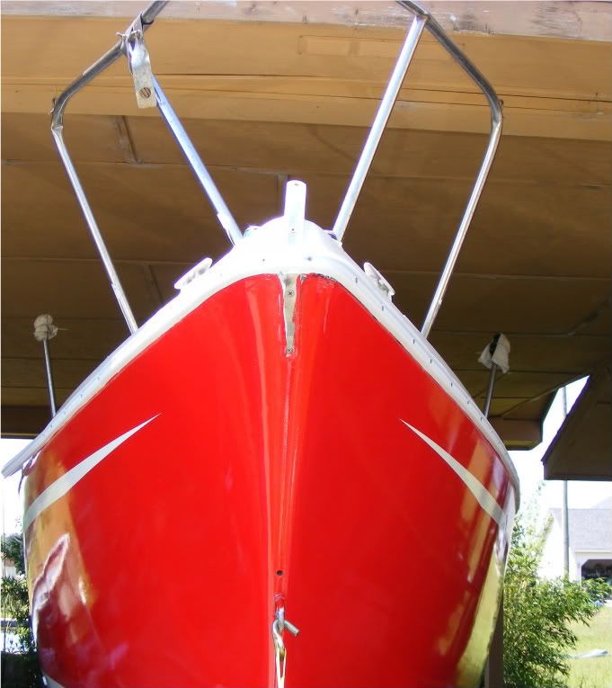

So far it is looking good, but this really sucks. I have been at it for an hour and half and completed 10 feet. I am being very careful and have mad it to the bow where I have to do my first bit of heating. Luckily it is a hot day and the rub rail is in direct sunlight.
I can look down the rubrail and see it is not perfectly flat but I think being in the sun for a few weeks will cure that. I would hold off if I where in a climate that is just averaging in the 60s right now. Hot sun is your friend.

Hair dryer worked really good, it got the rub rail hot and pliable but never got the fiberglass hot. Ran out of torque with a cordless drill with only 7 feet left with the first strip. It is coming along really well. You will have to excuse my paint over hardware, after it getting under the tape for the first couple coats of primer I decided to just let it go and sand it down after I finished the whole job.
