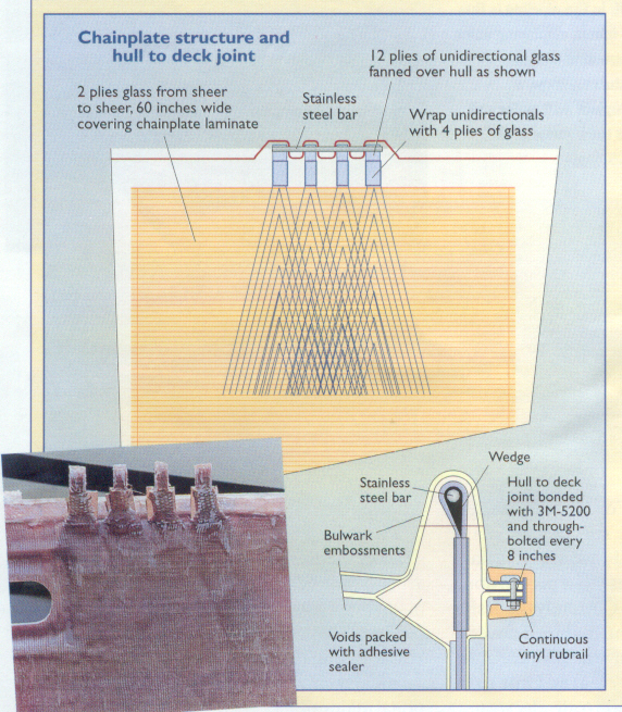

I have repaired my H430 rub rail. I understand my size boat.
I can help, you...maybe
