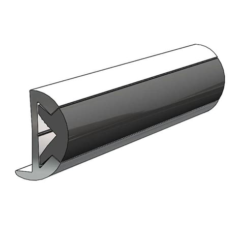

Your rub rail material is a vinyl extrusion that slides in a track. When pulled out mid track you have two issues. The hump is like a threat on a shirt that gets caught and pulled out.
  • You need to push-slide-encourage the rub rail to return to the proper length.
  • you need to position the fins on the bottom/top of the rub rail to go back into the track
Using a plastic tool you can try to gently push the fins back into the track. Work both sides.
While working the fins try to smooth the surface length wise.
Here is a typical design by Taco Marine. There are hundreds of different shapes.
