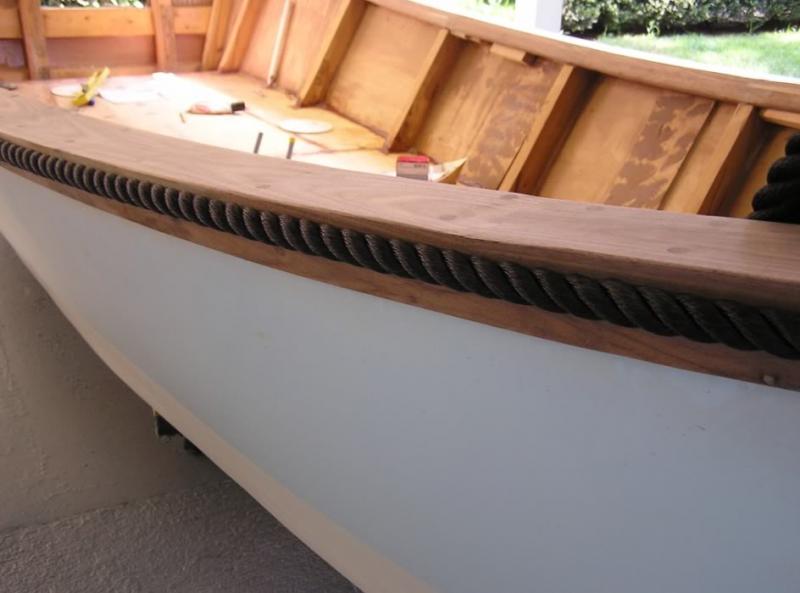

I saw a photo of a boat that had like a 1" black nylon rope glued in the aluminum channel to replace the former rotted rubber strip. I thought it was cool - I'd do it.
