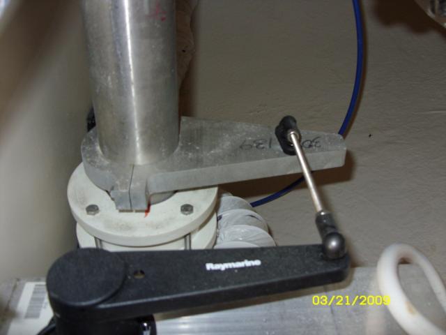

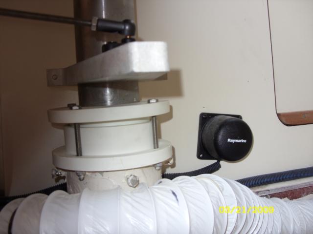

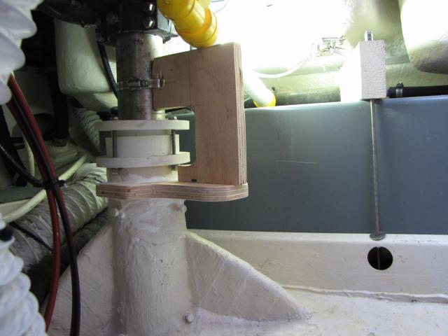

BTW, I was looking around on a friends 310 at his installation done by the boat yard and here are the pictures.
Sep 29, 2008
1,948
Catalina 310 #185 Quantico
Here are the pictures
Sometimes my mouse clicks too fast.
The mounted his RPS on a small piece of aluminum bent in an L, with one side screwed to the bulkhead right in front of the rudder stock. His fluxgate compass is mounted right next to the rudder on the other side on the starboard side of the bulkhead, and his computer is mounted right around the corner in his port lazarrette. All components in about a 3-4' space.
Don't quite think this will work for a 310.
One really interesting thing about his boat (on a totally unrelated subject) is that he has an extra tube for his salon table along with blocks and a cushion with a hard bottom to turn his port seat into a double bed.

Re: Here are the pictures
Interesting, the motor itself is what is mounted and keeps the inner ring from turning, no pedestal mount.

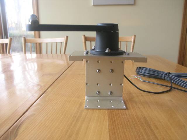

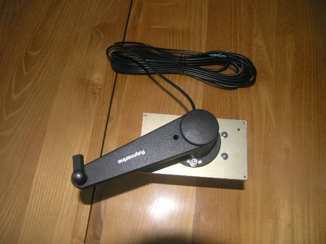

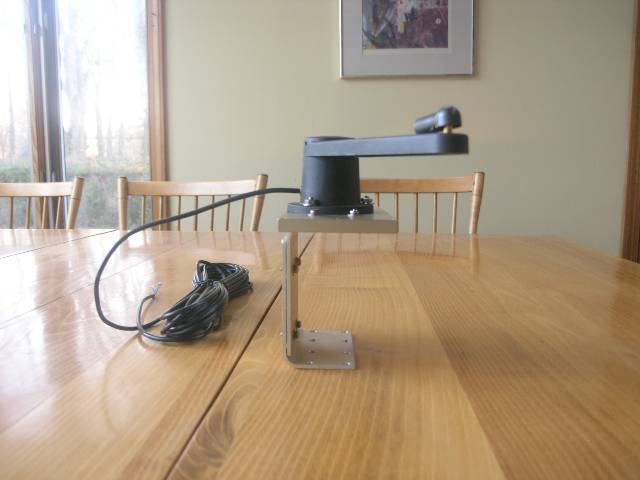

Here is the bracket I made for the RPS mount out of scrap anodized aluminum with stainless hardware. This will be mounted just behind the water heater. The swing arm will point aft with just enough clearance to the fuel tank. More pics to come.

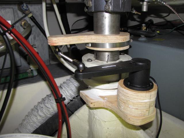

Well Fellows..........
I used the secant instead of the cosine.
It works just fine including the 60 degree cable stop locks.
paulj......:troll:

Pretty Impressive
Paul, I wasn't really sure where you were going with the earlier pictures. Now that I see it, it is pretty clever.
