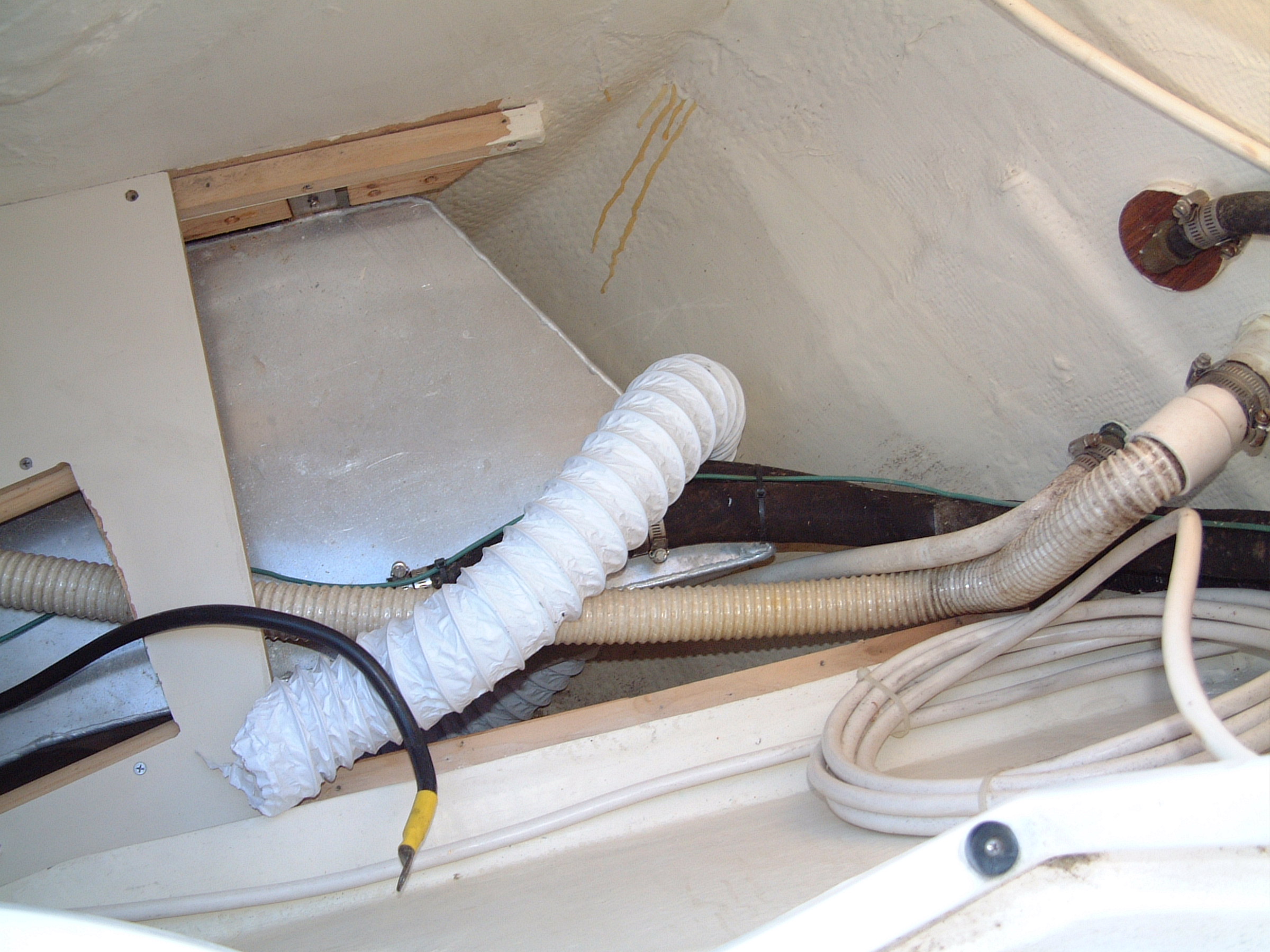

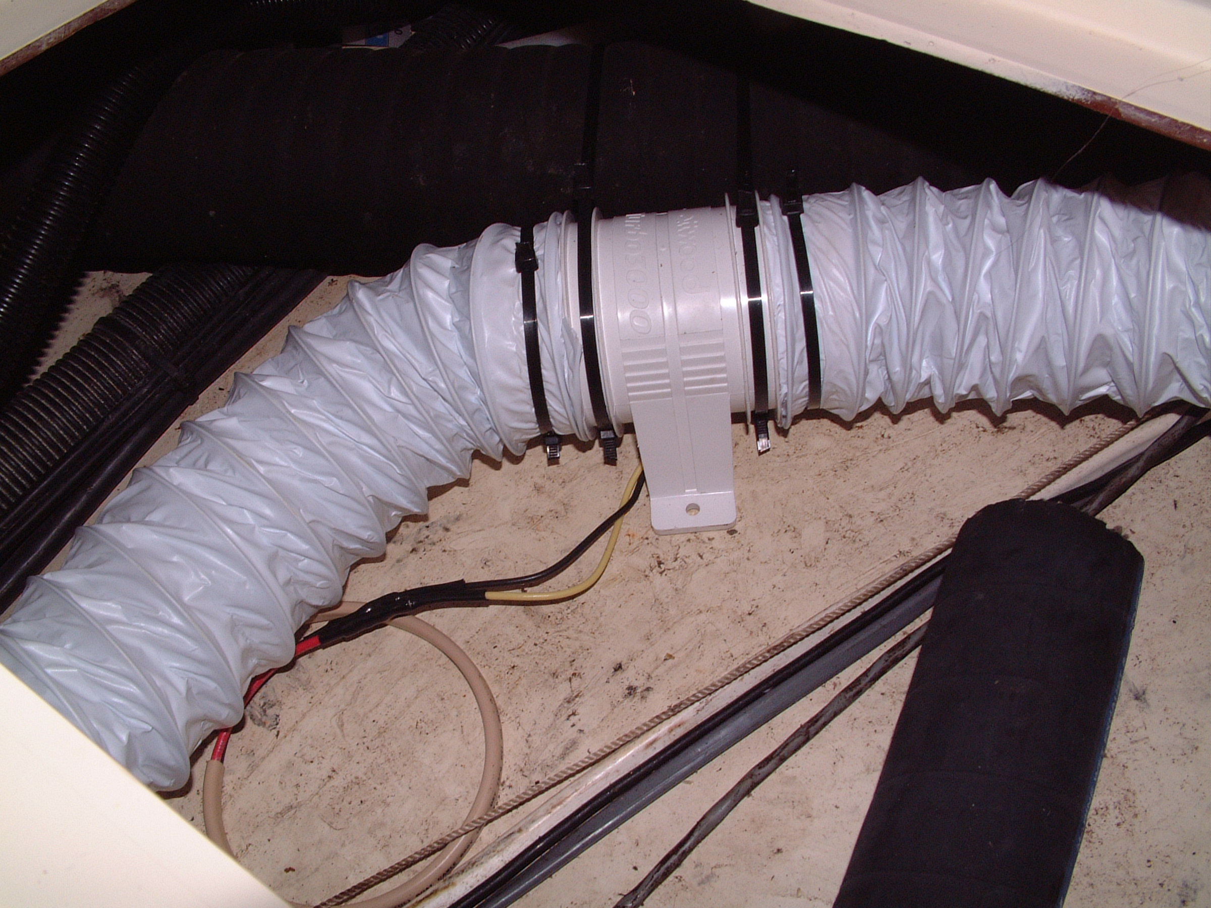

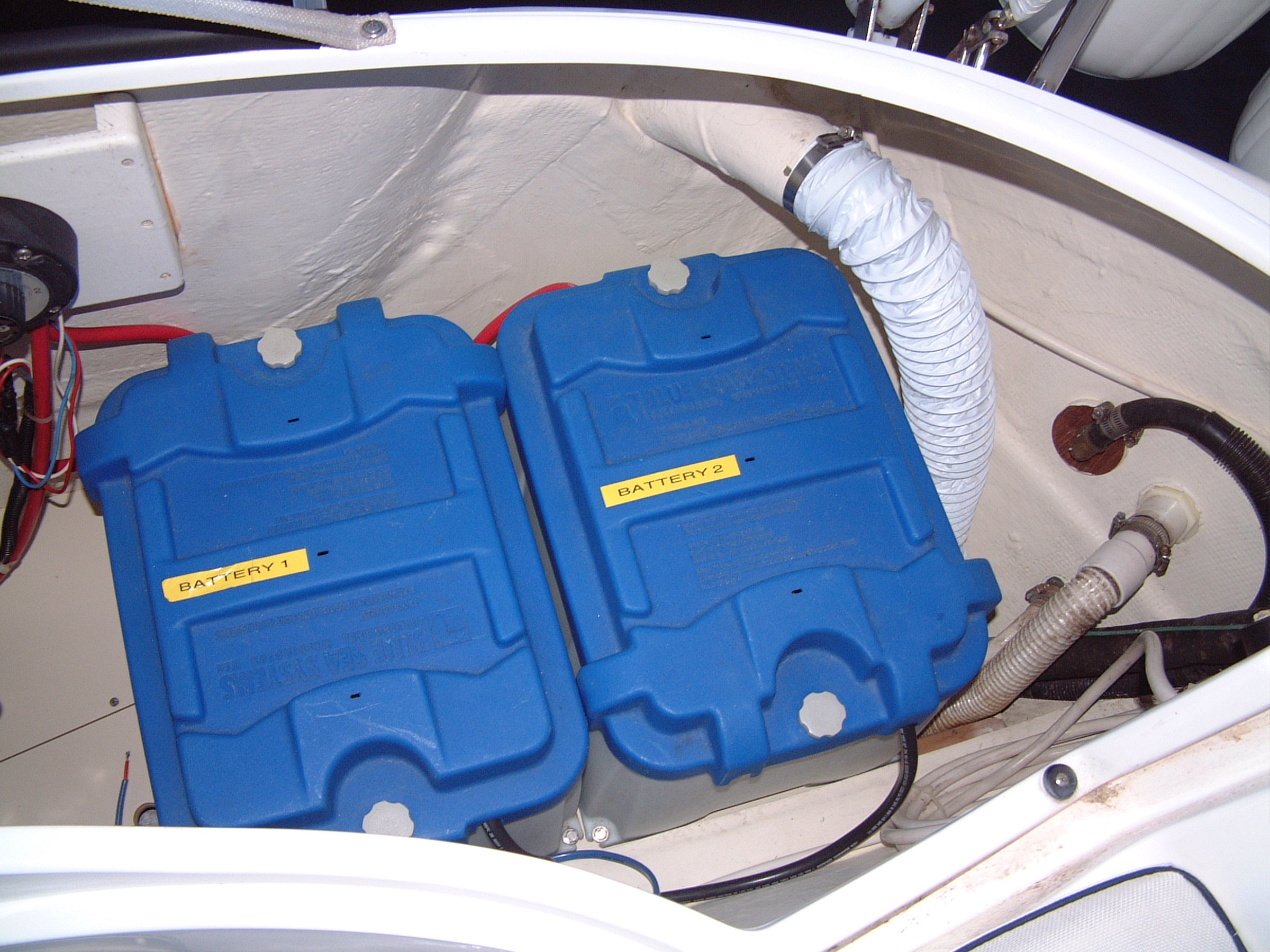

Dan- I have done this. I was cooling my alternator. I ran the 3" hose from under the alternator along the side of the compartment, thru the stuffing box area, under the aft berth edge and under the aft berth. I located the in-line blower under the berth and routed the exit hose to the port vent opening for the aft cabin. I used that existing vent for the engine compartment and plugged the vent for the aft cabin. I have a marginal internet connection now, but I will send all of my pictures asap.

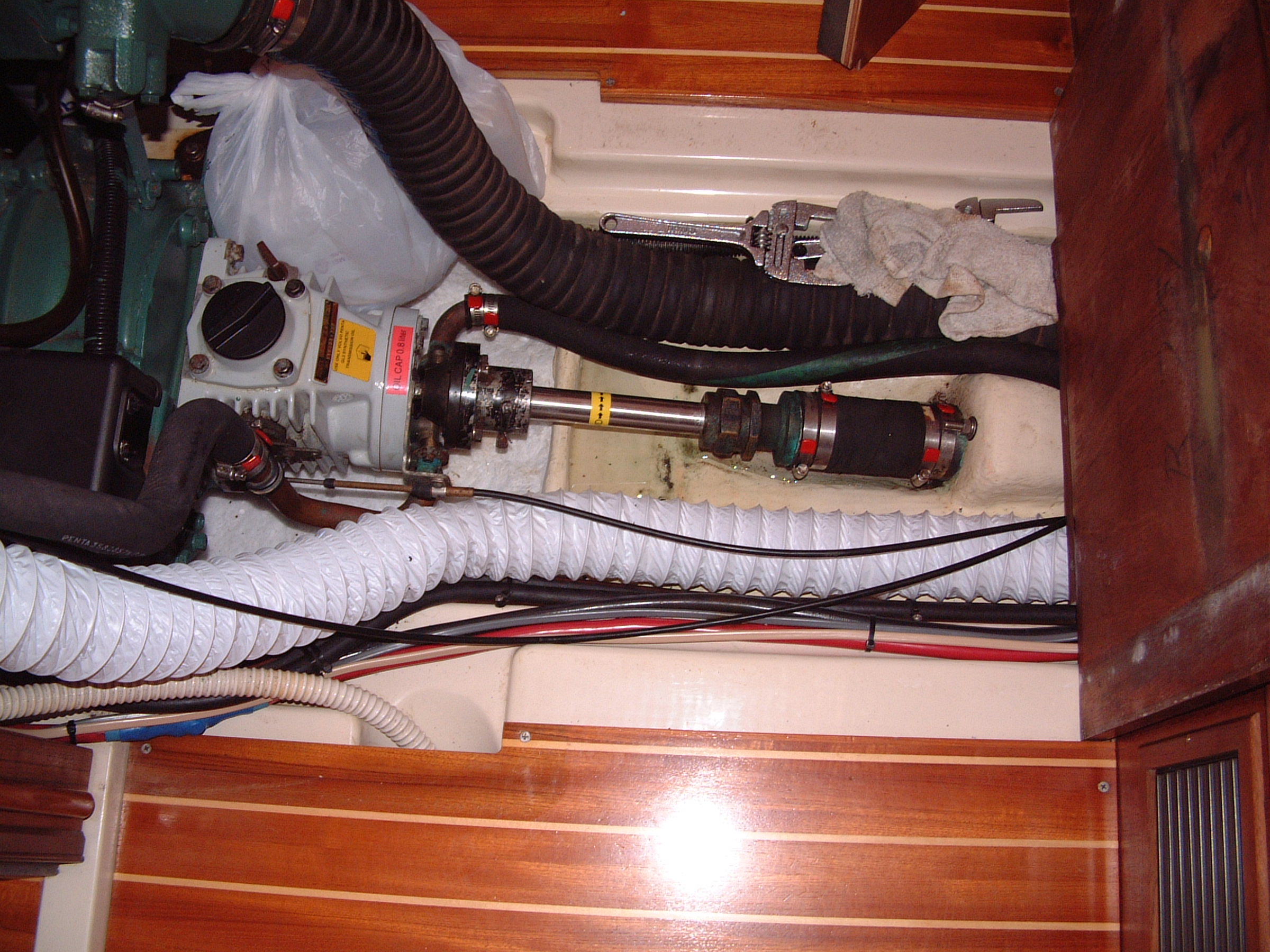

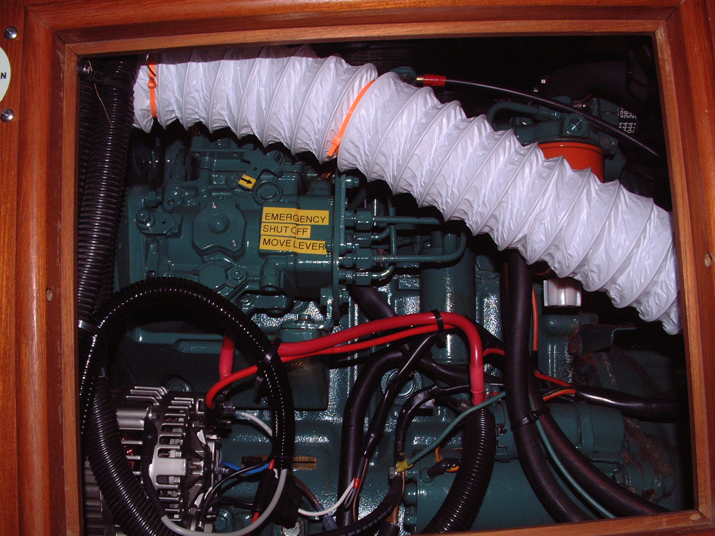

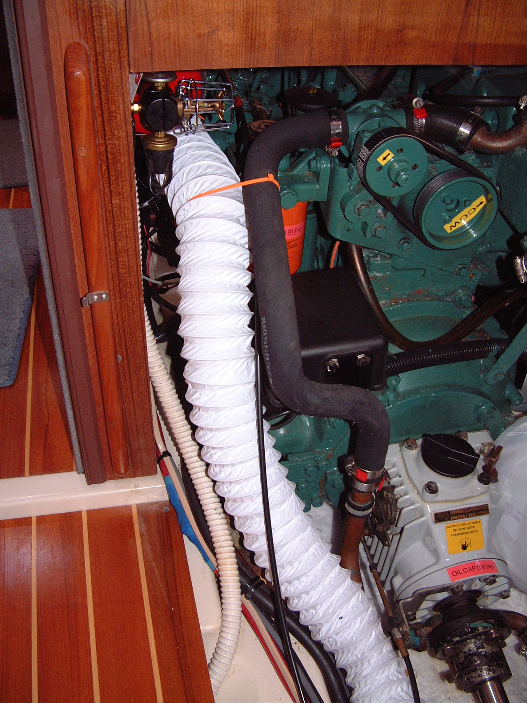

Here are the pictures I promised....
I don't remember where I tapped into 12V power, but the blower runs continuously with the engine.

Thanks Rich, That is exactly what I needed and pretty much what I had planned. Boy is that engine clean!!! Are you sure you ever run it? Don't know what I was thinking, my generator is in my stbd lazarette so I'll be running the duct work to the same outlet as you. Thanks again!!! Experience of others really cuts down on the learning curve.

Nice install Rich. Does the vent below the alternator blow air in or pull air put?
Feb 10, 2004
4,153
Hunter 40.5 Warwick, RI
Pulls the air out. The vent is on the air output side of the alternator. The Balmar has two internal fans that pull from the rear and push out the front where my vent hose is located.
