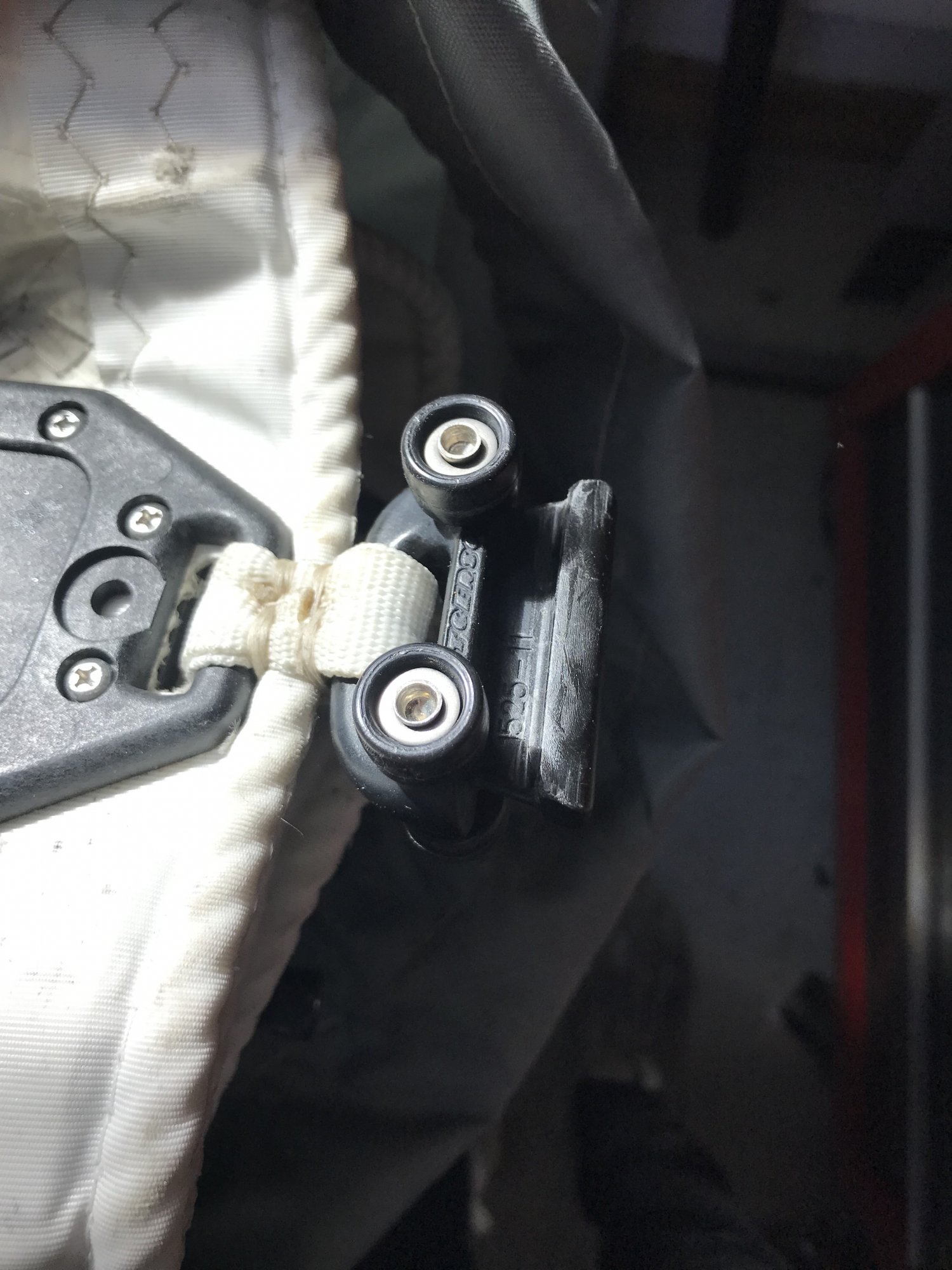

Never had a slug lock up in a the groove so saying it happens often is a little much - countless main raisings. On my current boat, the slug has wheels that prevent the slug from twisting:

Those slugs look incredible! Where did you source them? I can’t seem to find them online.

They came on the main when I bought the boat and were in excellent shape so I had them put on my new main, didn't have to buy them. The aft part of my mast is flat so the wheels have a good surface to ride on, they don't work on all masts I'm guessing. Here's one I found though the price is in euros, looks like they are called "pressure absorbing roller slides": Universal Pressure Absorbing Slide | Low Friction Mast Slide
