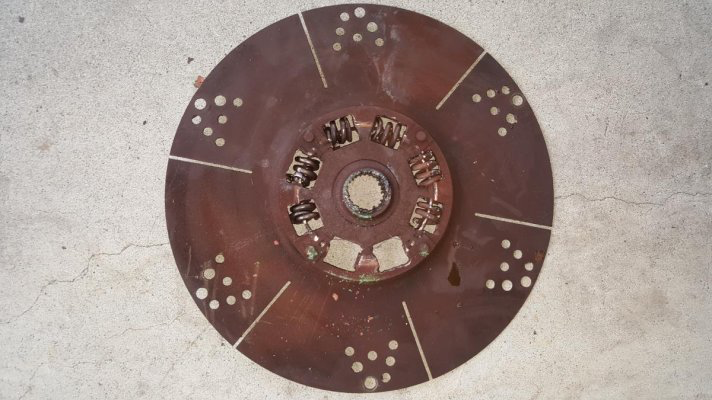

What is a damper plate?
A damper plate is a mechanical component that connects the flywheel of an engine to the input shaft of a gearbox, absorbing vibrations and shocks to protect the gearbox from wear and damage. It functions similarly to a shock absorber, ensuring smooth power transfer in various machinery, especially in marine applications.​
Here is an example of a damper plate.​
This one is bad. Can you tell why?​
You really can only know they are bad if you remove the transmission and look.​
Your suspicions may arise if you hear a lot of rattling at idle and when you try to put the transmission in gear it will not go is very difficult to go into gear.​
