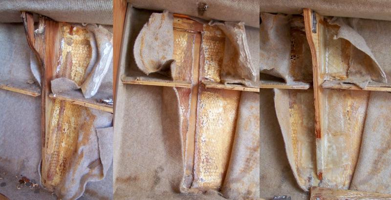

A few pics
Three pics show the damage, after I cut out the old bulkhead and the finished product.
I went through several tools, unsuccessfully, trying to cut out the old bulkhead through the fiberglass. Most tools were too awkward, didn't fit the room available, etc. Finally found the multifunction, oscillating tool at Harbor Freight real cheap and it worked great. Filled up the void left by the old bulkhead with West System, made a new bulkhead and glassed it in.
Wasn't a difficult job once I found the right cutting tool.
Use West System and follow directions. I had to call their support a couple of times because I'm slow to catch on, and the guy was very friendly and helpful.
