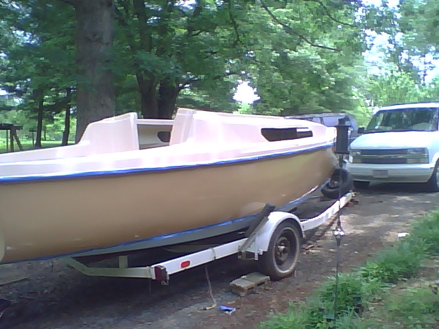

This is a roll and tip job that I did .... I used a 2" dry cut brush following a high density foam roller.
You can still see the masking tape. This is right after I painted the hulll .... You can see the reflection of the trailer in the the new paint job. The paint I used was by these guys.... "supermarine"
... and here is a pic of the finished job two years later. You can still see the water reflecting off the side. The supermarine paint takes about three days to harden up and a week to fully cure. So you can't walk around on the deck for three days (made that mistake) after you paint it.. But the paint continues to level that entire time.... so the finish is FANTASTIC.

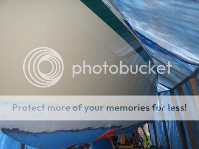

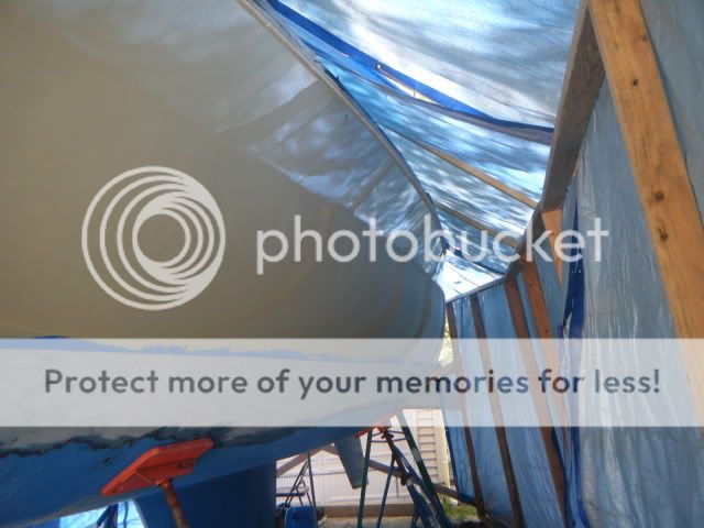

Priming is the biggest Grey area and in my case i used a Accuspray System HVLP Primer Gun as Alwgrip 545 primer is dangerous but manageable and to get a good result you need a good base
The Alwgrip manual recommends several brands of rollers like redtree that are easy to find and i used a metal tray bolted to my ladder in a FAILSAFE manner and a full width roller and a so so quality brush
Weather is KING and at least here right now thee has been to much humidity for a good result as it affects the final gloss tremendously
When i was done with the primer in the fall hurricane earl had other ideas about my completion date i did not get a good window until the spring which was no big deal a i had many other jobs on the refit
I did the job SOLO and its roll & tip just like it says the roll is just to put on and even film of paint the tip is ONLY to POP air bubbles and you MUST only TIP ONCE and wait for the miracle of modern paint to work
I rolled my way around the boat CC starting at the stern as allows to you a place finish on the starboard side without having to blend in a section of paint which will not work :eek:
A big one is the first coat of paint goes on completely different over the primer than the second cost of paint over itself and it is MUCH MORE RUN PRONE
I dont feel there is much magic in the rolling other than perhaps 24" something sections and then tipping DOWN
I say 24" because you cant reload the roller without tipping as each section MUST happen fast and you gotta move it took less then one hour per coat all the way around a 29' hull Or about 66'
