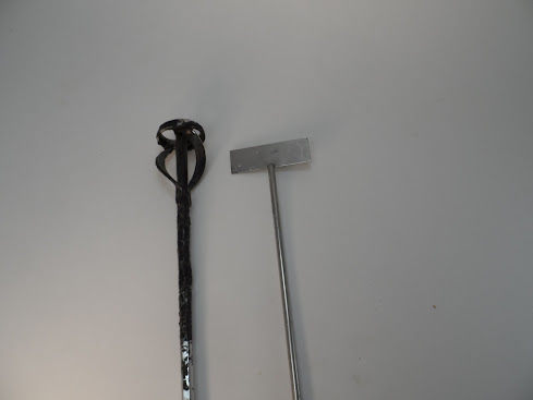

  • An effective drill-powered mixer. The one on the left clogs and is a pain to clean (it's only been used a few times). The one on the right will handle the thickest can bottom glop and wipes off in seconds (I've been using that one for 30 years--still clean).

I like your plan to stir the paint with the paddle. My usual method is mechanically shaken when purchased then periodically shaking until use, followed by stirring with a paint stick. I’ll be updating that method!

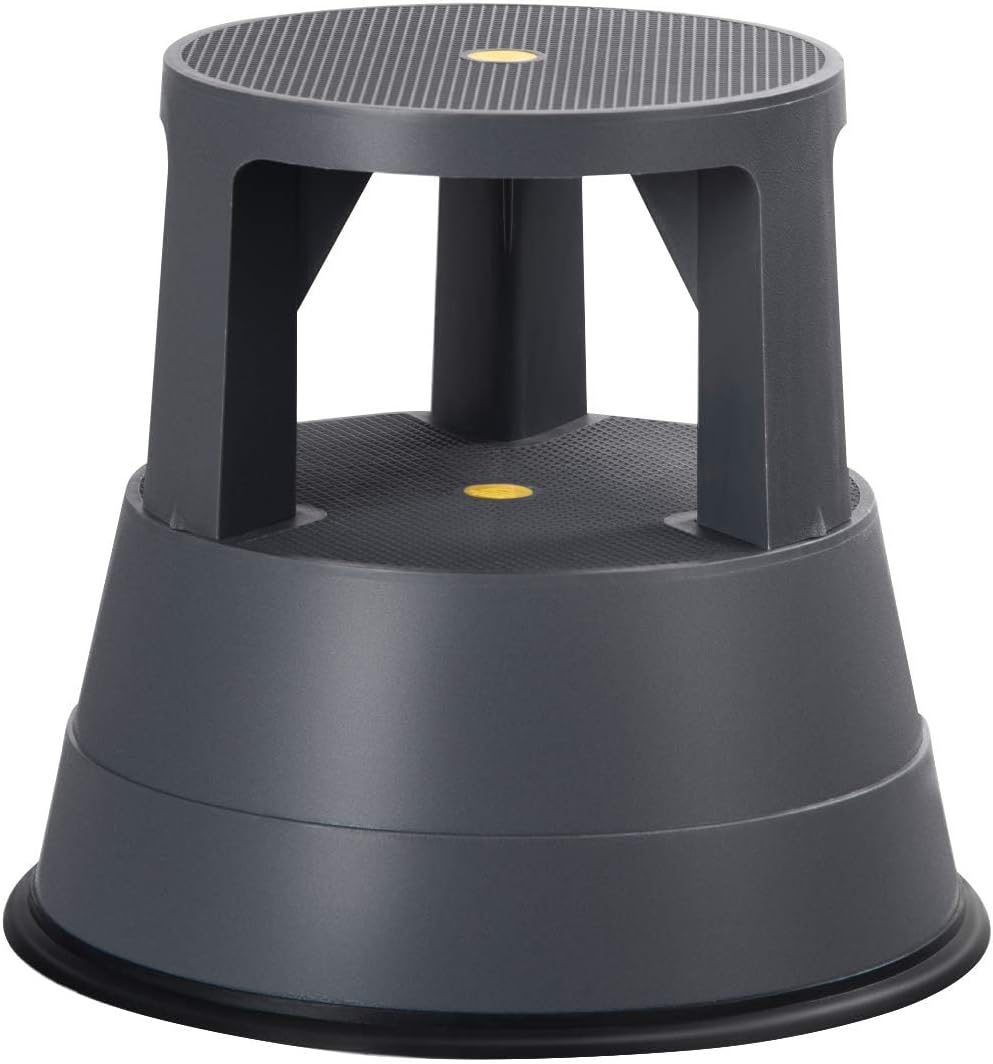

I was hoping for leads on a seat, like a rolling step stool, that rolls until you stand on it, then grips the floor. Only in an outdoor version. Not asking for too much or am I.
Worth a conversation at least.

Painting will be better with the short extension (just a plain stick IMO--light and fast and no need to adjust unless your boat is huge--certainly it is less than the 8 feet a standard wooden pole is for, and there is no ceiling or reaching over furniture). You would never be in one place for long enough to sit, I promise. And no stool is going to roll on a drop cloth, which you will be using.
Sanding I get. Google "library stool." That is where I remember seeing them, and there are a lot of hits. I can see it could be handy on good pavement. But again, are you not required to use a drop cloth to catch the dust and chips, which would negate the rolling stool? We are, even with vacuum sanders.
