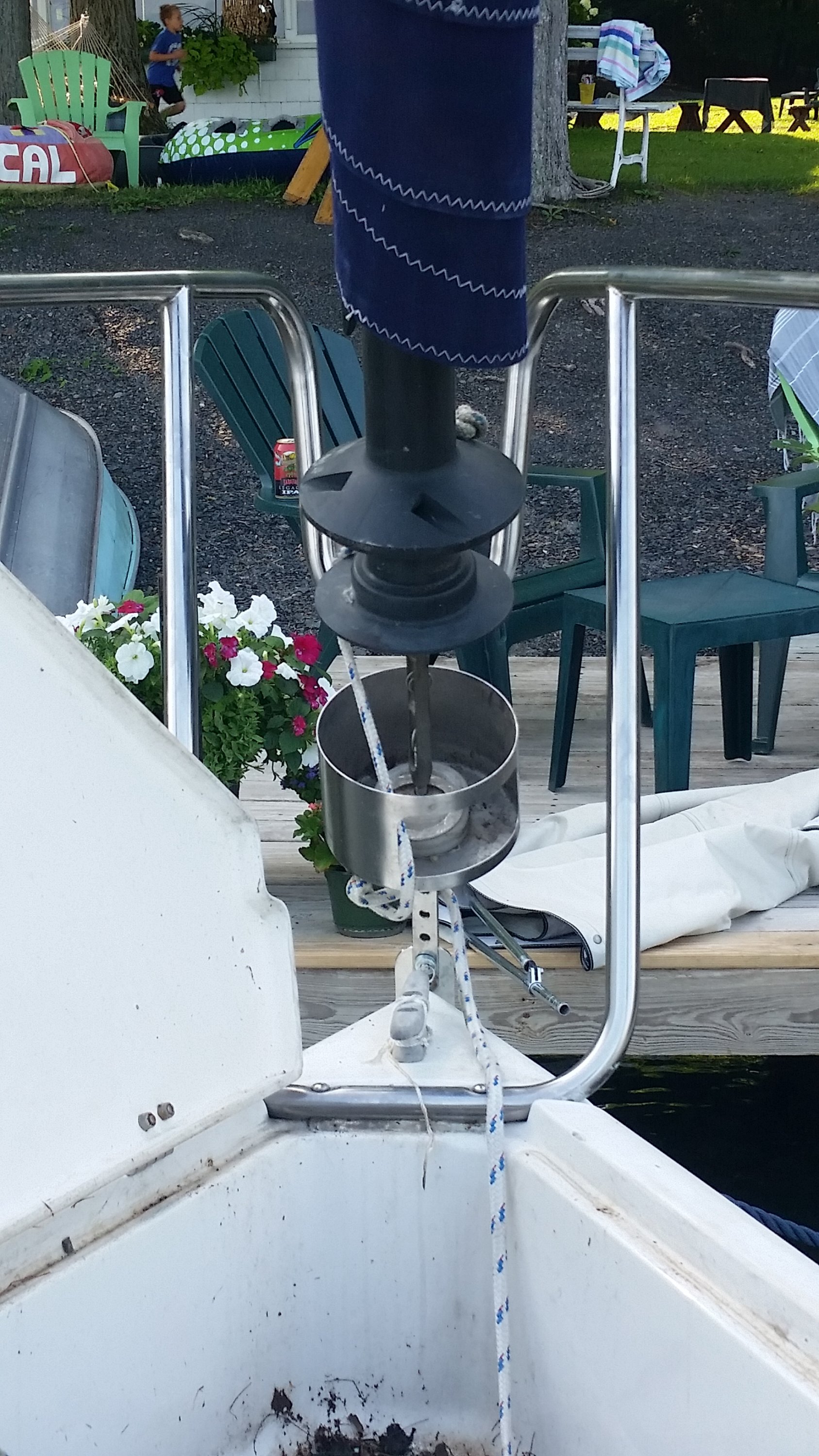

The jib is raised but it seems it's too high up on the wire and won't come down to lock in the track at the base.any suggestions?

Pictures, man. We need pictures!

If I understand you, the tack does not connect directly to the drum. A short line is used between the strap on the drum and the clew.

Well, that sorta looks like a CDI furler, but I see nothing on the top of the drum to tie off to. Can anyone confirm it's an older model?

Since I never heard back from you, I will try to answer this but first is that a screw hole on the side of the black upward section under the sail I see in the photo? Are there two holes? Any hardware or holes which to screw into on the other side of that drum? Also the two endentations, is there a direct hole between them>
