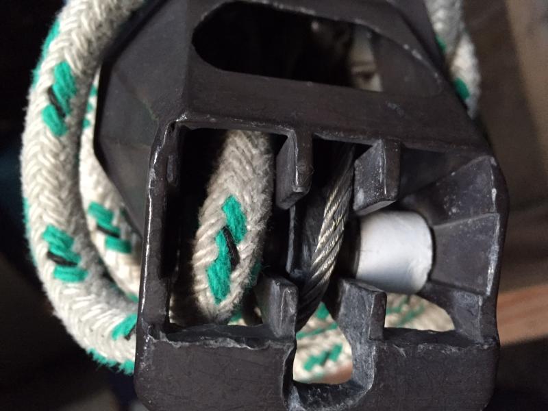

I just purchased a 1985 Pearson 28-2 and need to replace the rollers for the outhaul at the end of the boom.
Any suggestions on where I can purchase these and get them out. They look like they would be a universal type of roller.

I just replaced one on my Wilderness 30. There are many different sizes available and only one to fit. I dis-assembled mine to get measurements, Diameter, Width, Shaft Dia. and matched it up at W.M.
Most of the online stores have them too. Just match it up.

Thank you, Are they just held in there with tension ? is appears that the shaft they sit on just drops in. I am heading back to the boat and will inspect closer today.

When you get to the chandler sites, search for the word "sheaves"
