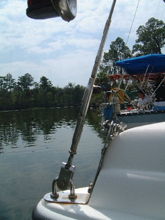

Did you have to modify the headstay to install it? What about the deck clearance? I'm not sure if this applies to the 260, but the U-bolt for the headstay on the 26 (see picture) is about 6" below deck level, and the CDI setup requires reducing the headstay length and adding a 6" tang to elevate the drum. Where does your control line go? Did you add a cleat for it in the cockpit, and if so, where? I was impressed at first with the Snapfurl, and now I'm thinking that keeping the sail on the headstay on the road maybe isn't such a good idea anyway, especilly since the boat's in the water most of the time.

Tom My 260 is different from your picture, and I did not have to modify the forestay. There is no problem with deck clearance for the drum. I did add the fair lead, and routed the furling line down the port side. One thing I did add was a rubber sleave under the line eyes, because they were just a bit too big for the life line stantions. On the 260, there is a cleat right next to the stantion nearest the cockpit, but I don't use it. Once the sail is furled, I tie the sheets around the sail, and it doesn't unfurl. It's been a great addition to my boat, and after reading the stories about the CDI and one instance were the guy almost lost his mast due to the modified forestay breaking, I'm glad I choose the snap furler. Hope this helps. You can contact me directly through this site if you need any more help. Dan S/V 'Unruly Julie'
