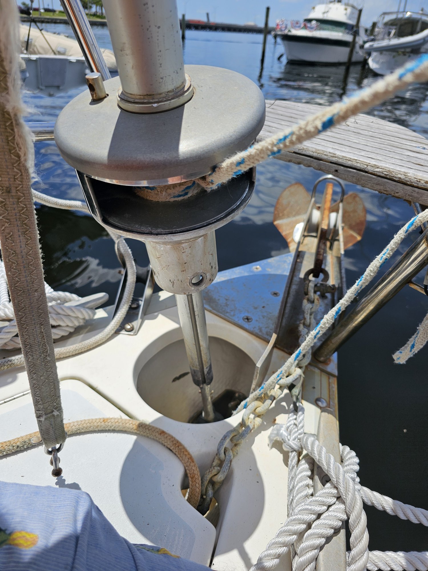

Update:
I've started another thread with this information, but nobody has responded there...
I've taken every screw, pin, etc out of the furling 'drum' and cannot gain access to the knot that holds the line in the drum.
I thought about cutting the bad part of the line, then whipping the hell out of it, whipping the hell out of the new line, then sewing them together as a replacement. That being said, I'm still a bit concerned about the strength of the sewed line.
I've researched online and found a way to splice the lines together, intended for a jib line, but called continuous loop, they say (line manufacturer made the video) it's still at 90% of the strength by doing it that way.
Anyone have experience splicing lines end to end and have a failure or success?
I'm not looking at this as permanent, just until I can save enough to buy a new furler system.

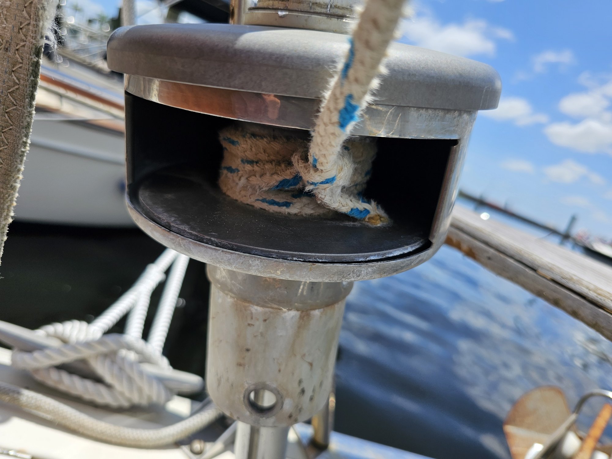

It is NOT continuous, it's knotted in the drum and, as shown, after a few wraps (unsure why)
I've researched and found it's usually a ProFurl, I've emailed them.
I DID get the stripped screw out thinking that'd make that bottom piece come off, it didn't, though I'm guessing it's got at least some corrosion holding it in.
On the top there's a spring clip holding the housing on, I tried to remove that and only had some loose bearings come out, it wouldn't separate from the bottom to access the drum.
I'm guessing the top is what needs to come off, but not knowing what brand or model this is would make it hard to find bearings to replace those that are there.....I'm also guessing the spring clip would need replacement too.

It us actually fully pulled out. There's 3 wraps on the drum and a knot keeping it that way.

With sail fully pulled out, there should be much more than three wraps on drum (if it is a single line reefing system). Somehow you’ve got a “rats nest” tangle there. I would get a sharp knife and cut all of that chafed line off the drum to evaluate what’s going on. You may have to remove the headsail or wrap it manually until you figure it out and get another furling line installed. Again if all fails, call a rigger and watch what he does to repair & get him to explain operation of the furler.

I cannot get the drum apart to remove the old line.
I've already purchased the new line.
I'm trying to figure out how to get it apart so I can remove the 3 wraps, the knot used to keep the wraps and the knot that holds the line on the drum.
I'm trying to see if anyone knows how to get that housing apart so I can get all the old line out of the boat and replace with fresh, new line.

As I mentioned, cut the line off the drum. Then you may be able to see where the knot that attaches the furling line is located. Also be sure to note how the line wraps around the drum; clockwise vs counter-clockwise. If you install the new line incorrectly, the furler will not work. I have a newer Profurl model. There is a slot in the drum that permits you to push the knotted line thru the slot to extent that knot can be untied or cut without disassembly of the drum. But, my furler does not resemble yours. Good luck.

That is not a Profurl. I think it is an old Hood furler. The line shouldn't be wrapped and knotted like that. Cut the knot, remove the line, and it should be obvious how a new line attaches. Either a hole in the drum axis, or a hole on the top or bottom of drum that you don't see with the cover on, or a clamping mechanism.
