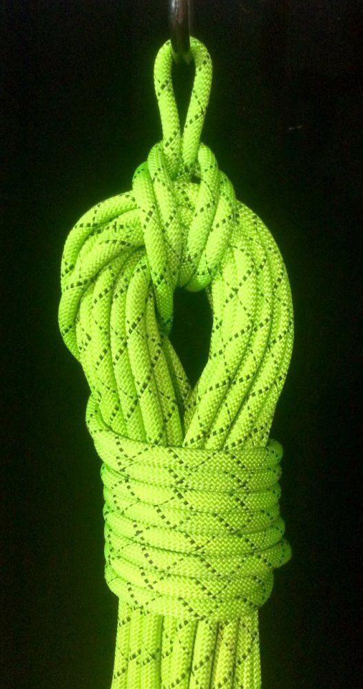

I have been coiling this way since college (NAVY). However I use a different finish. I drop the last two loops of the coil, and bring the end of the line to the hand holding the coil. This gives me a long loop to create the finish instead of a single line. Using this loop to tightly wrap the coil, you end up with a loop instead of the tag end of the single line when your done. This allows the coiled line to be hung from a hook in your line locker, or if you leave a larger loop, from a winch on your deck or mast. It looks like this when done.
