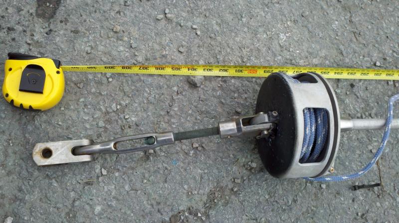

A lot of Cherubinis either came with the Hyde Streamstay or had them added. You can compare yours to: http://www.rigrite.com/furling/hyde/hyde.html . Here is a picture of mine. Took it off the boat and have a new Harken to install in the spring. The Hyde is a solid rod furler, the furling rod is the forestay. There is no separate wire forestay.

Thanks Ed, but mine is different with a heavy wire guide(bent in a circle at the end) where the furling line enters the drum. Will keep searching.
Jun 2, 2004
5,802
I have seen that furler. Just two stamped round plates with one heavy wire guide between the plates. Compared to mine the diameter of the drum looks larger. I want to say it is an older ProFurl but I cannot locate a picture of one.
