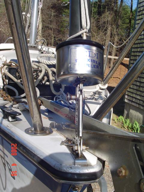

I bought my CDI FF-2 off Rudy at D&R Marine and he told me that it would be wise to buy the furler without ball bearings. There is a large flat washer that the drum can spin on that comes with the kit and this is adequate for this size furler. He said that the ball bearings can fail after a while causing the stay to break.
My furler seems to work fine without the ball bearings. I added a 5" tang to my bow plate to raise my furler drum enough to clear my anchor when it's stowed on the anchor roller. I also use a press button Quick Pin to attach my furler to this tang. I would never use a "Fast Pin" on anything.
I had my Gennie converted over to fit on the furler luff and they installed the UV shield. This sail is a little up swept at the clew so that I can see under it. I don't think that they supply the control line with the furler so buy enough line so that you can install the cleat near the stern somewhere. Don't mount the cleat before the Gennie winch or the sheet will snag on it every time you come about. This was one of my screw ups that I finally corrected last year. Live and learn. Outside of that, you can't beat a furler.
