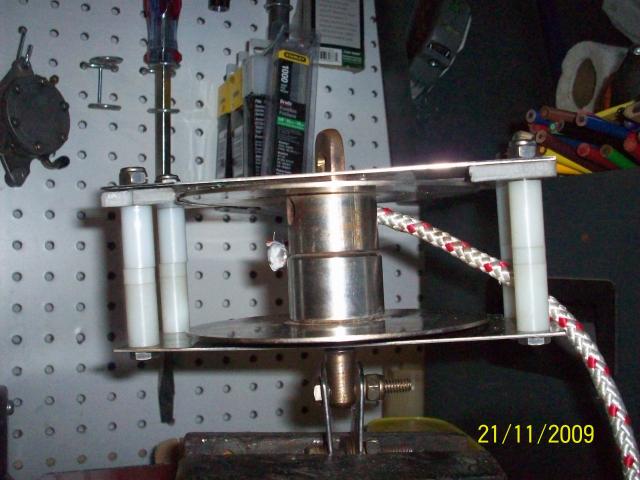

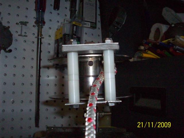

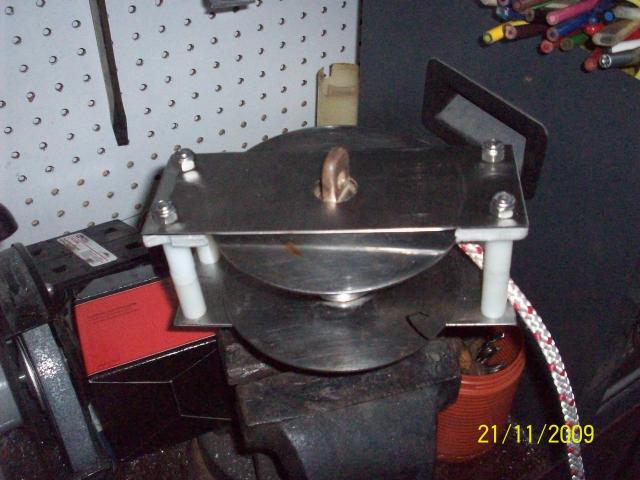

I added the cage to try and keep the line in the drum. It was a real pain before. I am not sure if it will work or not. The drum was completely open before and the line had a tendency to drop and wrap around the bottom and make a real mess.
