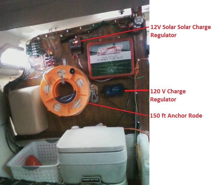

12,553
I've seen these at boat shows may be useful! It son a reel and attaches to the railing...cleat it off
I did something like that on a MacGregor 22 I used to own... but for much less $$. See pic. I had 150' of 1/4" line on one of those orange reels used to store electric extension cords. The reel is $15 and you can deploy the rode very fast... and roll it all up nicely as well.
