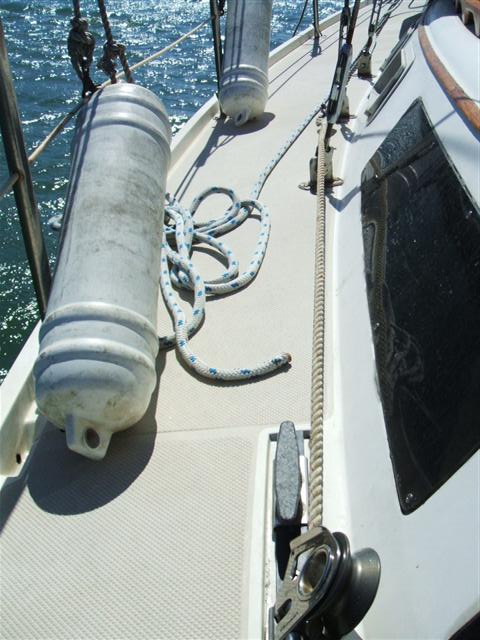

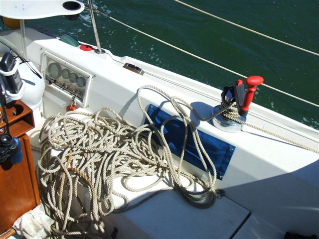

How about a picture, sounds very interesting. We've used our jib sheet winch(s) for hauling the anchor rode up when things get windy or the anchor is stuck deep (like it should be!).
Stu, is that lead foul on your turnbuckle? You might want to consider a snatch block on a stanchion base or something...
--Tom.
23,353
Good point
I don't do this all the time, actually it is unusual when or if I have to, but you're right. I'll watch for it next time, thanks. Wow, so much to continue to learn.
Oct 22, 2008
3,502
- Telstar 28 Buzzards Bay
That's probably only foul because the sail is probably furled... the sheets on my genny do the same thing...
--Tom.

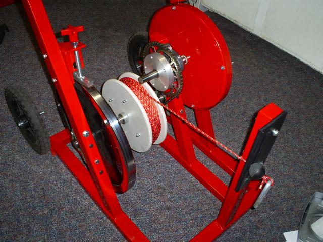

I'm glad someone else is asking unorthadoxed questions instead of me. This is my latest invention. It may have some application to what you are talking about. This machine is for running resistance. So you have a chest harness on and hook the cable up to your back. When you run away from the machine it turns the flywheel, which is used for resistance. The red can is a spring can for hose reels. It reels up the rope(3/16" sta-set) when you walk back. This one holds 130'. With a bigger reel you can hold more. The spring cans come in stainless, with stainless springs. I'm going to order one of those just because they look cool.
Anyway you could have a cable ran back to the cockpit that has a brake on the reel to stop it from reeling up until you are ready to pull the hook. Release the brake and motor up while it reels up your rode.
The flywheel has a clutch bearing in it so it will keep spinning even when you are done paying out rope but you would eliminate that altogether with an anchor retrival system. I would build crazy stuff like this if there wasn't so much stuff to just fix on my boat.
