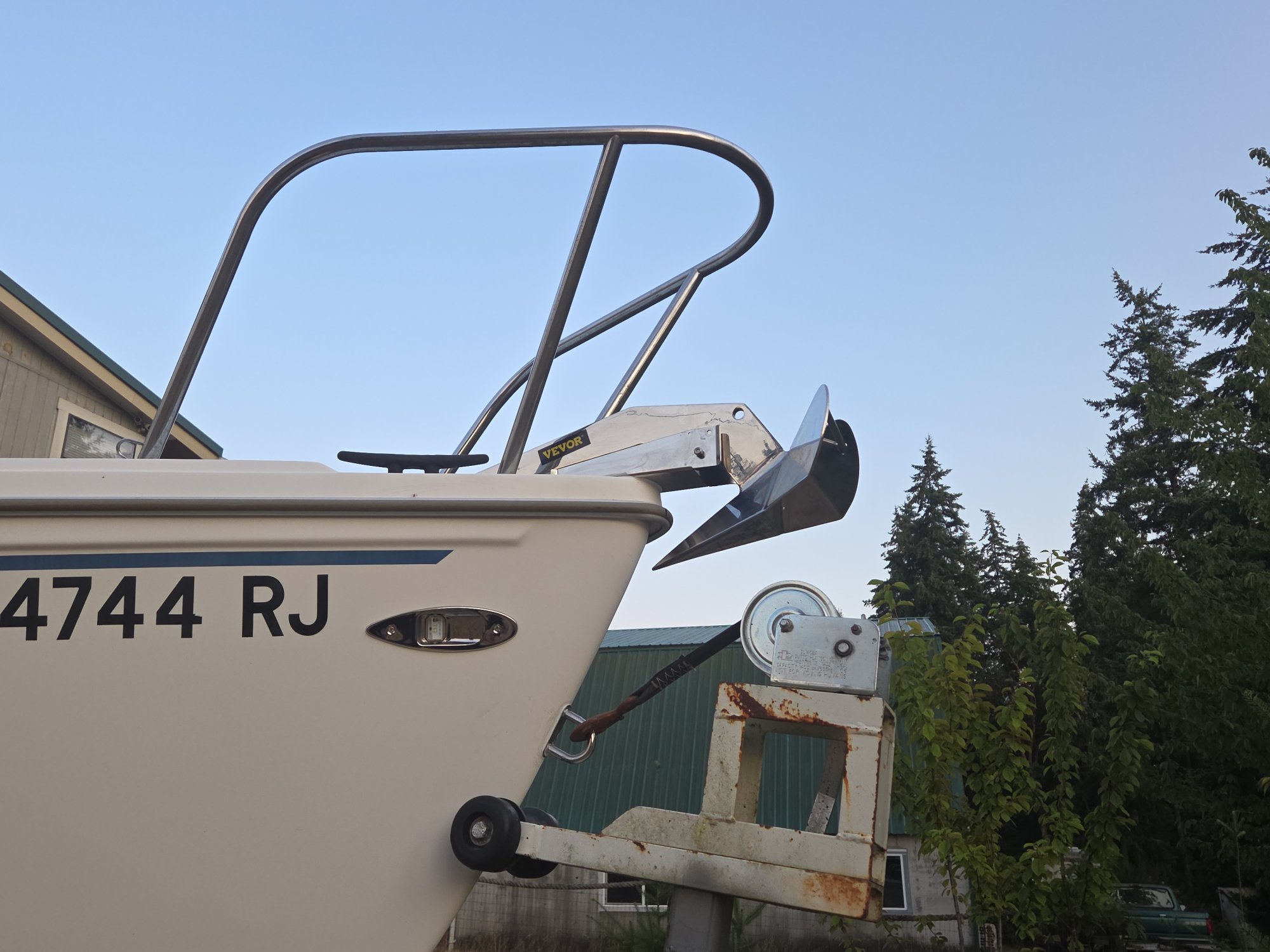

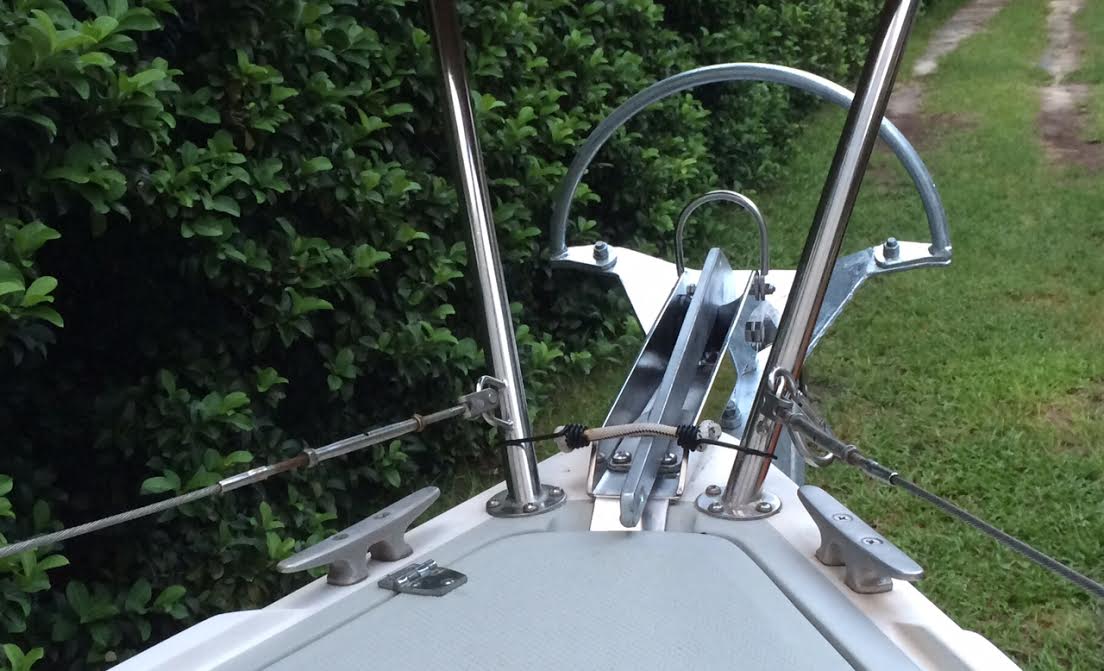

I have no experience with Rocna, but I doubt it (or any properly sized new generation anchor) will fit in the locker. Nor will the CD anchor roller carry any style anchor sized appropriately for a place like SF bay, in my opinion. I tried.
I went down this road with Mantus, nine years ago. I had to settle for a 13lb model. I wanted 17, but there was simply no way. Happily, the #13 has been 100% effective.
The only way I found to mount a "real" anchor on the bow was to buy this anchor roller from CD and modify it to fit. Even then, I had to cut out a small section of the anchor locker hatch so it could close over the anchor shank.
It was all a monstrous pain in the butt, expensive and time consuming. It was also the single best thing I ever did to make Daydream a better boat.

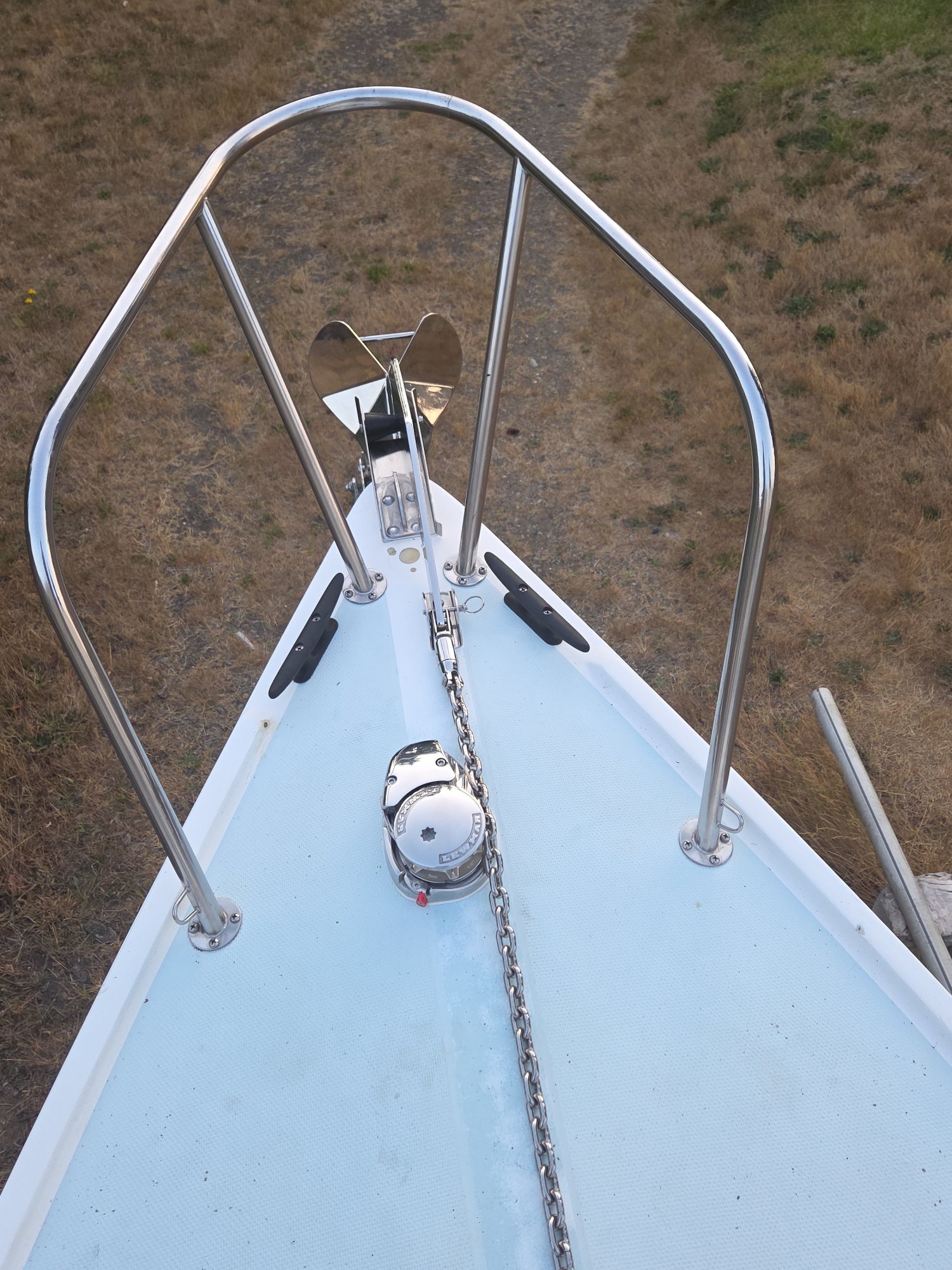

+1 to everything @Gene Neill said above. I ended up with a similar system - in my case, a 15-lb Manson Supreme on a Lewmar roller. Agreed that it was a substantial project, and a very worthwhile one.
If it helps, there's a side-view picture here, with the A-frame bowsprit mounted.
No, No, No to the San Juans - everyone should stay away and leave it all for us :) Just kidding - very highly recommended! We've been really happy with the new-design anchor in the SJ conditions - I'm sure a Rocna or Mantus would perform similarly to our Manson.
Ensure your ground-tackle system includes plenty of rode to handle the large tidal swings. And sometimes even larger farther south in the Salish Sea, if you end up heading that direction.
fly out and make it happen gene! That looks great
