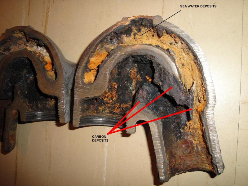

The dirty (not nasty) picture below MAY be your problem but as you say, you have low engine hours so maybe not. We'll wait to hear your answers to questions a) and b) above and then on to a little more navel gazing.

Thank you all for your help.It was the mixing elbow confirmed yesterday.Can anyone recommend a Yanmar dealer i am located in St Kitts looking at probably Miami,Florida area.Checked neighboring islands no luck.
