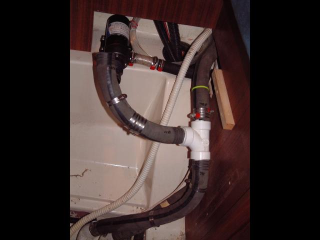

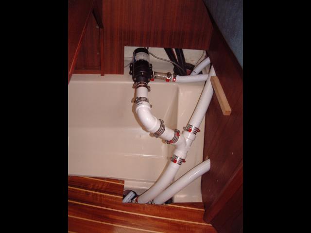

Moving the macerator
I can't exactly remember where Hunter installed the macerator, but I do remember that it was in a spot that was not very accessible.
At my second macerator rebuild, I moved it from wherever it was to the location shown in the attached picture. Now I can rebuild without removing the unit and I can get to it by simply removing the seat at the nav station.
The attached pictures shows my current macerator location. The first picture was taken after I moved the unit and the second picture (with the white hoses) was taken when I was replacing my holding tank.
Of note, the intake and output hoses of the macerator both run downhill respectively to the tank and to the overboard discharge thruhull, so waste should not sit in the macerator itself.
I do not have the odor problem expressed by Rick D.
