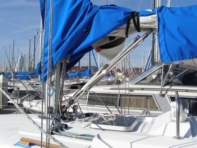

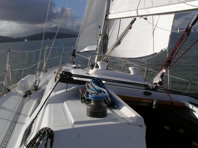

Suggest contacting Mark at Garhauer Marine at 909-985-9993 to discuss sizing (easy to measure) and mounting brackets to mast and boom for a solid boom vang model RV 20-1SL for 28-44 ft boats. Each is custom made for each boat. I recently installed that one on a Hunter 31 without a topping lift. Once you install the boom vang you may be able to eliminate the topping lift. Photos attached.
