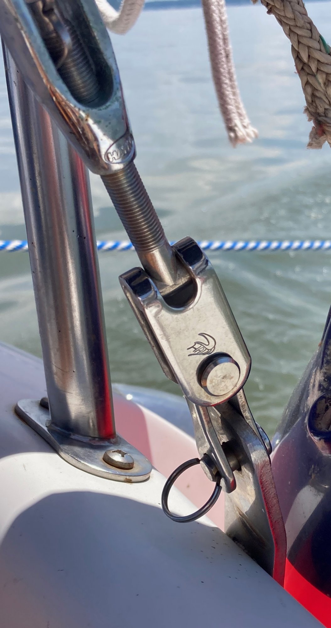

Best place to purchase rigging hard ware? I want to get two hardware extenders for Hunter 40.5.

What I am looking for is general hardware, longer turnbuckles. We just moved the boat and had the mast down and it was very hard to get the rear stays hooked back up.

The length of the turnbuckle may not be the problem. If you tighten the forestay too tight, the rear stays may not reach the turnbuckle to engage.
Longer turnbuckles might not be able to tighten enough. The real question is, mast in column?
Check first here call the SBO Store for turnbuckles.
If no luck then try Defender in your neck of the woods.
