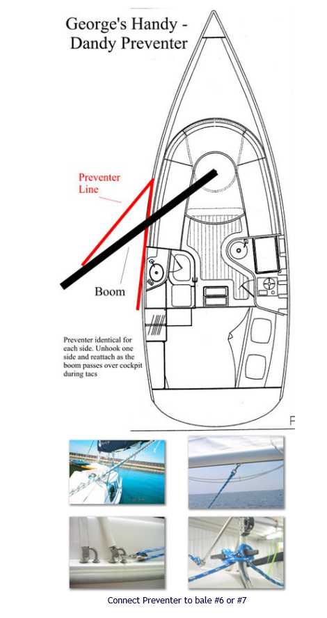

The articles (with diagram and photo) below explains how to set up a preventer.
Below is a diagram of how it was set up on a Hunter 260 from Mistress of Grand Traverse
Jun 2, 2004
649
Hunter 23.5 Calgary, Canada
On my H23.5, I rigged my preventers exactly as shown in Georgia's handy-dandy diagram. Except, I run the lines through the blocks on the shroud U-bolt blocks back to the stern cleats instead of a stanchion base. I attach the snap shackles to the same eye as the mainsheet. I'm never in really big winds on my small Lake. When going dead downwind I use the Preventer on one side and a whisker Pole for the jib on the other and it's rock solid.

Two different systems depending on sea state and windforce, makes sense. My H260 is a lake sailer in mostly light air and I want to prevent (another!) accidental gybes while on a run. With the snap shackle to the mainsheet bale and a snap-on block at the shroud U-bolt, its quick and easy to rig just when you need it and you only need one set Good stuff, thanks!

One line meaning you can simply unhook the block and move it and the line over to the other side if you switch tacks. Once the boom is out in position, you have to tighten (adjust) the preventer line, pulling the boom forward with it while the mainsheet is hard. Its probably easier to set up two lines, but on a run I generally don't gybe that often.
