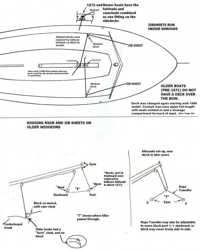

Does anyone have a drawing or manual of the rigging main and jib sheets on
a widgeon. Not sure which year I have but it does have the deck over the bow. There is a topping lift that I believe someone added along the way.
Just getting started but want to make sure I have all the parts.

Here is the diagram that I created for my WIDGEON Manual, it shows the approximate way that the Mainsheet and jib sheets were rigged from 1963-78, changed were made during that time, mostly the location of hte jibsheet blocks.
I can supply a copy of my manual if desired, I do request $20 to cover printing and postage, but that includes the Manual and scanned copies of all the Widgeon Sales Brochures that I have.
